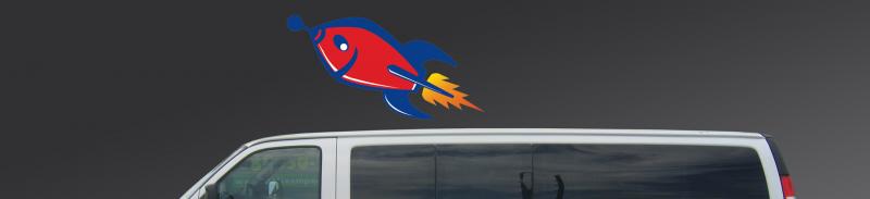

Here is a rough representation of what my client is looking to do. It would be about 60" from the tip of the nose to tip of the flame. I would need help figuring out a mounting system too.

Cool Rocket Design.
Mine was mounted to look 'military' & parallel to the roof line. Does this mounting system need to be removeable? Will they allow you to bolt a baseplate to the roof? If so that is the route I would begin but I don't know too many clients that are going to be overly excited about drilling holes in the roof of their vehicle & then having exposed hardware in the interior of the vehicle but it would be the easiest path to go down for creating a mounting system IF it is potentially acceptable by the client...let us know more,if this is a utility van not a passenger or conversion van it may be an option.
regardless I would build this on a mounting plate maybe with stainless or powder coated rods attached to the mounting plate supporting the 'missile'.
I would recommend contacting 3D sign co (Bill) I haven't seen him around the forum for awhile but he can build this in a variety of ways I have multiple ideas on how to construct this feel free to call me & we can talk through it based on customer expectations, budget, & if this is going to be a one off or has the potential that you will need to fabricate identical matching pieces in the future.
I'm not tooled to produce this but can suggest a few shops that I know can produce this once I know a little more info. Call me in the am if you'd like, I was going to call you tomorrow anyway.
dan@esigns.com
grafixemporium
I haven't really gone over mounting scenarios with them yet. The van is a passenger van currently used to shuttle people. We are finishing up a fleet of brand new shuttle buses for them, so my feeling is they plan to take this van out of service and just use it to as a big billboard. If that's the case, I doubt they will mind putting a few holes in the roof as long as we silicone them up and make sure they don't leak. However, that would probably entail pulling the headliner, etc.
I'll discuss mounting options with them later. For the time being I need to get some numbers together for the project to get approval.

Dan, for now, the project is a one off for the only passenger van they have. I don't see them putting these on the shuttle buses because clearance would be an issue. Of course, quality is important but it's not going in a museum. I'm already in touch with Signmeup. I sent emails/specs out to a couple of other recommendations, too.
As far as production methods... I don't know enough about it to make a decision. I don't know if foam is durable enough. I think fiberglass would certainly be fine. Let's just say it needs to withstand the elements for a 3 to 5 year period.
I can't answer the repair/replace question because I don't have a clue what a project like this is going to cost. If it's too cost prohibitive, they likely won't even pull the trigger. I'm here to find someone who can recommend the best method and build this thing for us.

The logo doesn't lend itself to being 3D. The blue shading and white highlight is the problem. How do you represent that in a 3D object? I think the client will have to accept some creative license if they want a 3D version.
I expect a safe/durable one off of this 6 feet long with a bracket would run you about 3 grand.
Maybe a flat cutout would work better? Or semi 3D with some bulging to the sides and 4 fins etc.
