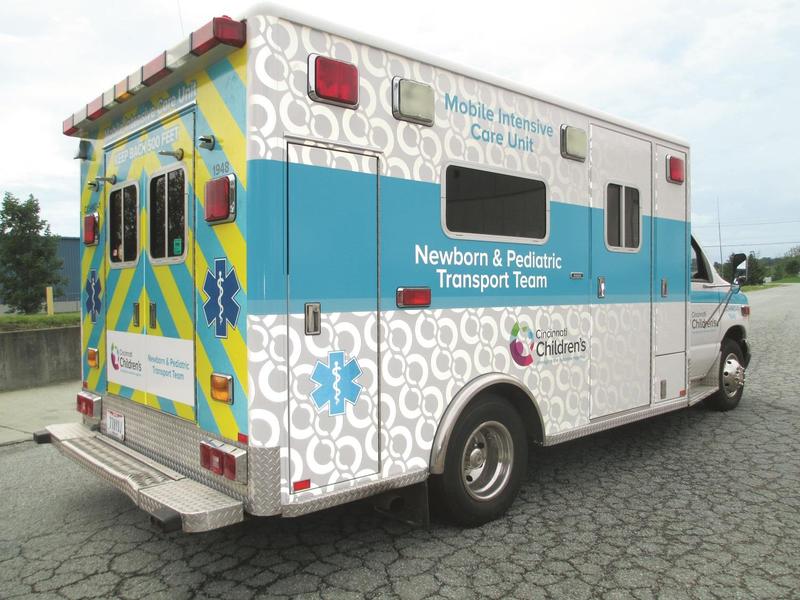

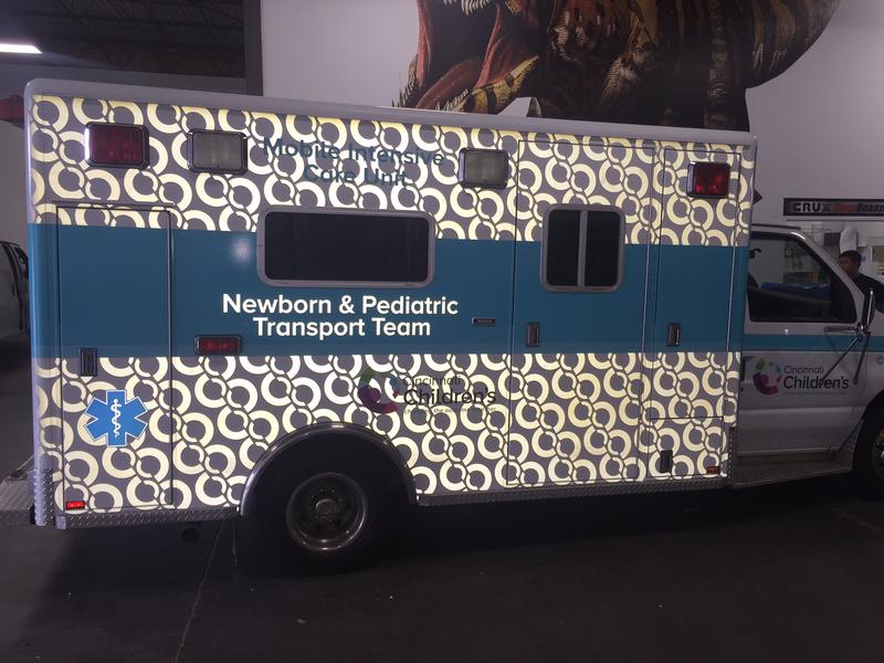

Take a look at the Epson printers. We run two of them here and they really aren't that bad to have indoors near you unless you're running them both on dark inks for extended periods. We run a LOT of white ink through them also, beautiful prints. The ink is DRY and ready to laminate within hours - for rush quickie short-term jobs you CAN laminate immediately. They also have metallic ink option, but we don't run as much of that; only one of our printers has that option enabled, the other one has a cleaning cartridge installed in that port. Ours print beautiful colors, WAY beyond what our latex is capable of.
I would suggest pairing it with a Graphtec or Mimaki plotter. We run Mimaki and Summa plotters here and our Summa acts up WAY more often.
The attachment is white printed onto IJ680CR-10 for a really unique look without layering. (the "C" is the reflective showing through)
