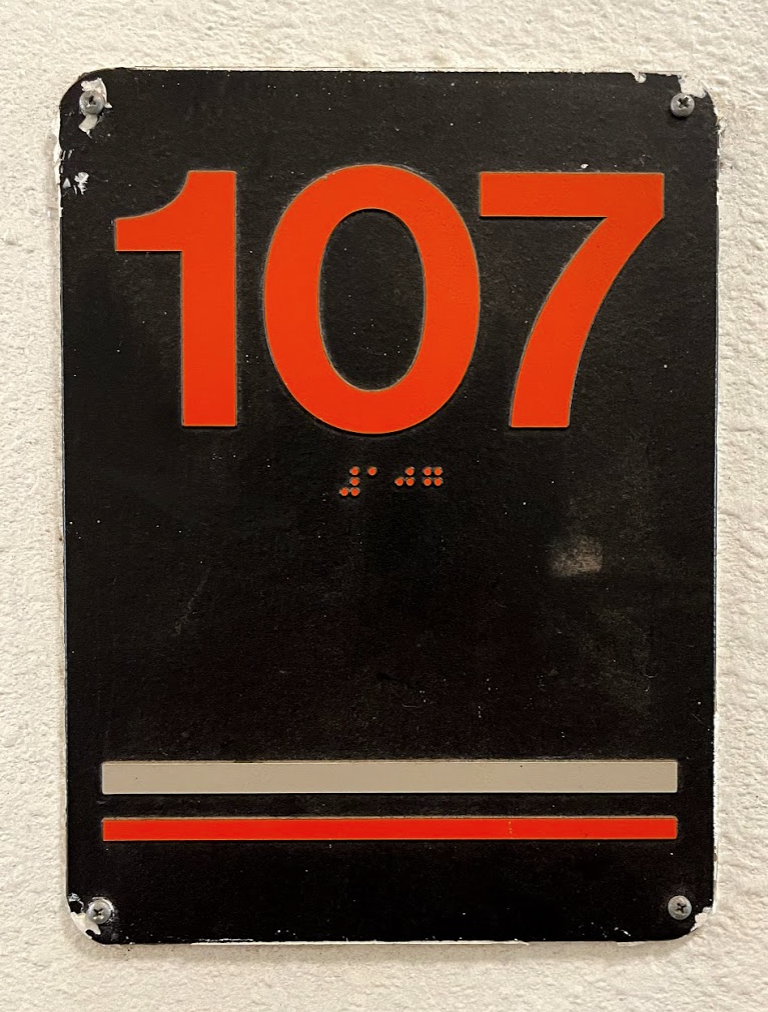

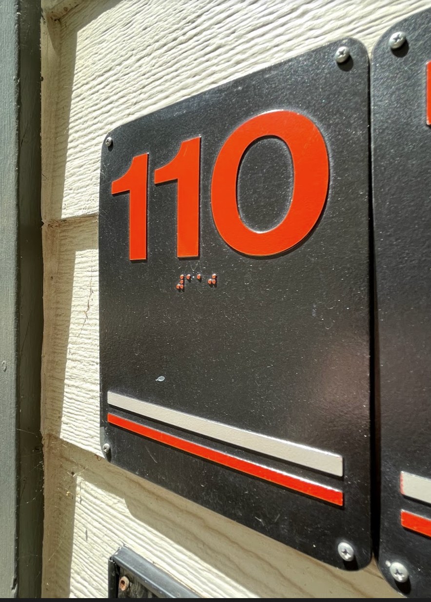

I've got a customer (apartment complex) that needs a replacement unit sign similar to this one -- see attached --
(2-color orange/gray on black, 6" x 8" w/ pictos + "braille", qty 1)

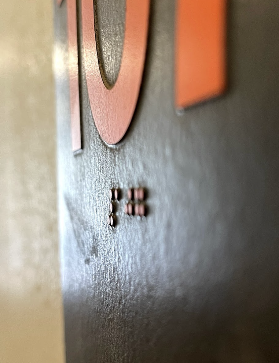

I'm not sure how the original signs passed inspection because the supplier gave them (what appears to be) 3D UV pictograms, including flat UV braille (no radius, no spheres) -- but I'm not worried about it because I'm only giving them a single sign (not replacing any others).
And while I do have the engraving equipment to make a proper ADA sign in-house -- it's not worth buying 2 colors of applique and setting up the engraver for such a small job. So I'm looking for a supplier that can make this for me -- presumably with a 3D UV LED printer. (quick and cost-effective)
Suggestions?
