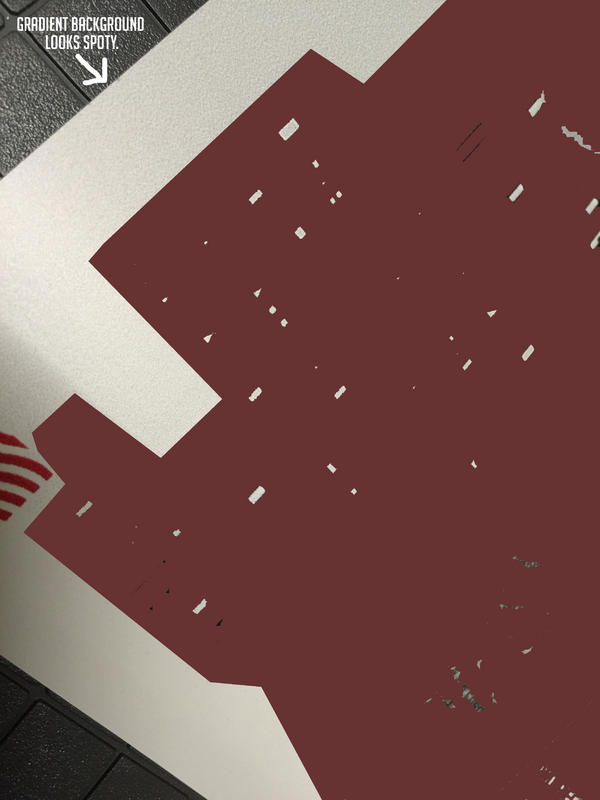

I need advice on how to print gradient to make it to a better quality instead spoty quality print. (Image below-background) Had to cover up the artwork for customer. Also I have done the research on google, but doesn't seen to solve the issue.

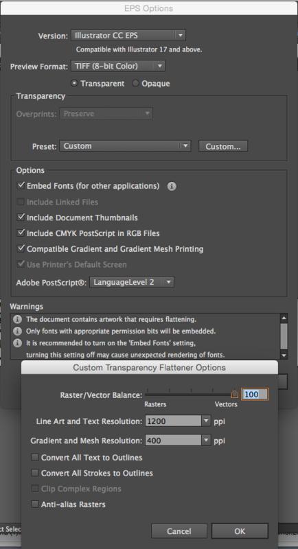

4. save as .eps (AI setting in attachment)

AI: Adobe Illustrator

I also print with other material from 3M, Avery, both are glossy finish but results were great, crisp and vibrant color, no spoty.

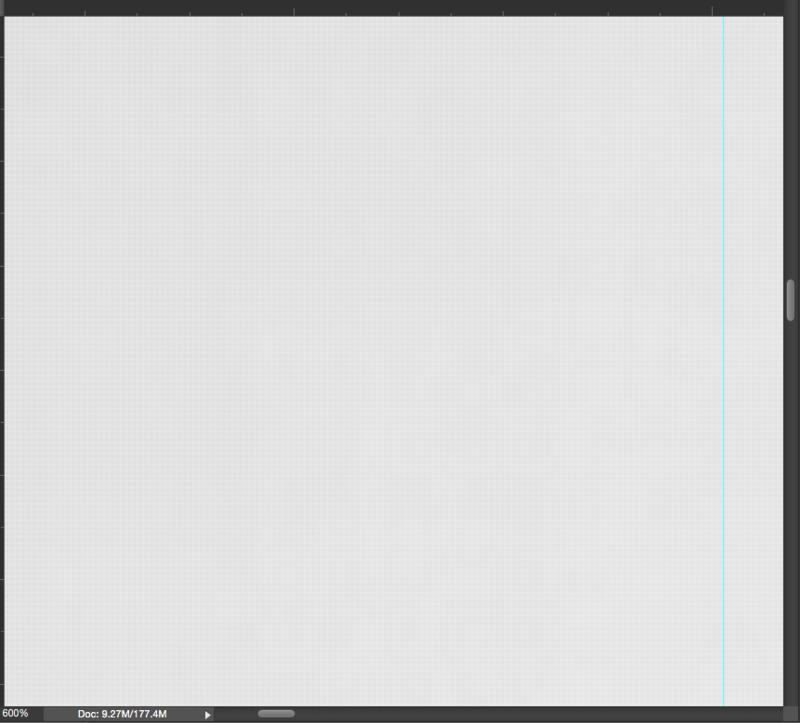

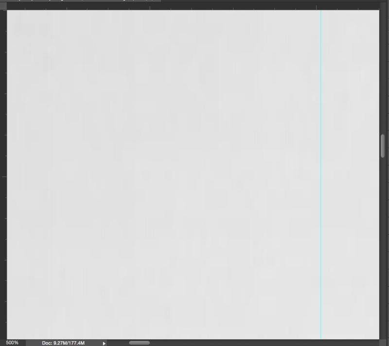

I have zoomed in the PS to 500% looks fine, but when I zoomed in at 600% you can see the background starting to pixelated. And for the AI I zoomed all the way in to the limit 6400%, still smoothing as 100% zoom.
I have attach the images.
PS 500% zoom
PS 600% zoom
AI 6400% zoom
