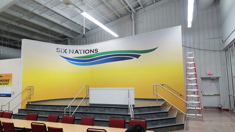

Some excellent advice here!!! We just did a wall that had a curve in it so there was a lot of drywall compound so I insisted they primer the wall before I wrapped it and the area that had the curve didnt accept paint properly so that panel pulled away from the wall, I suspect they didn't hire true painters just did it themselves.
