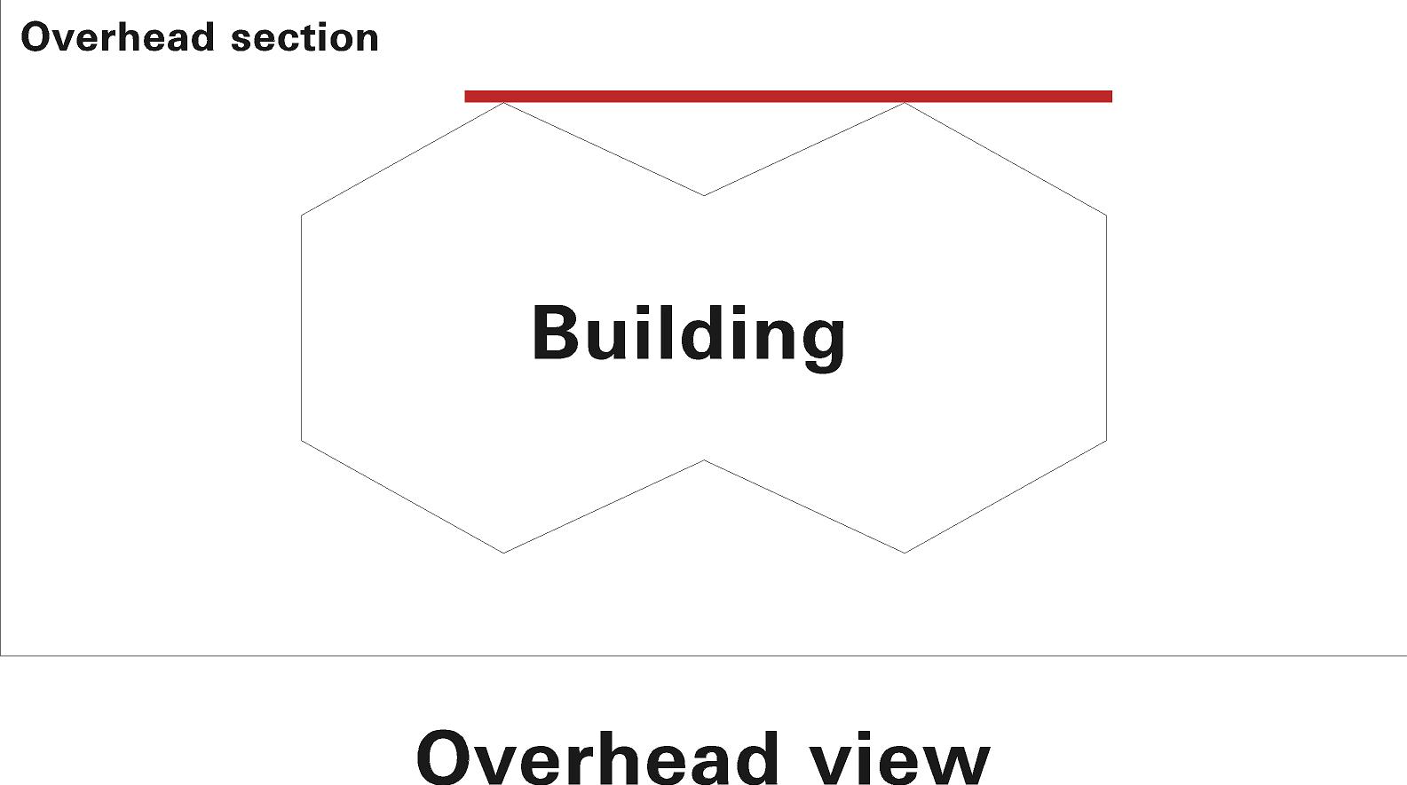

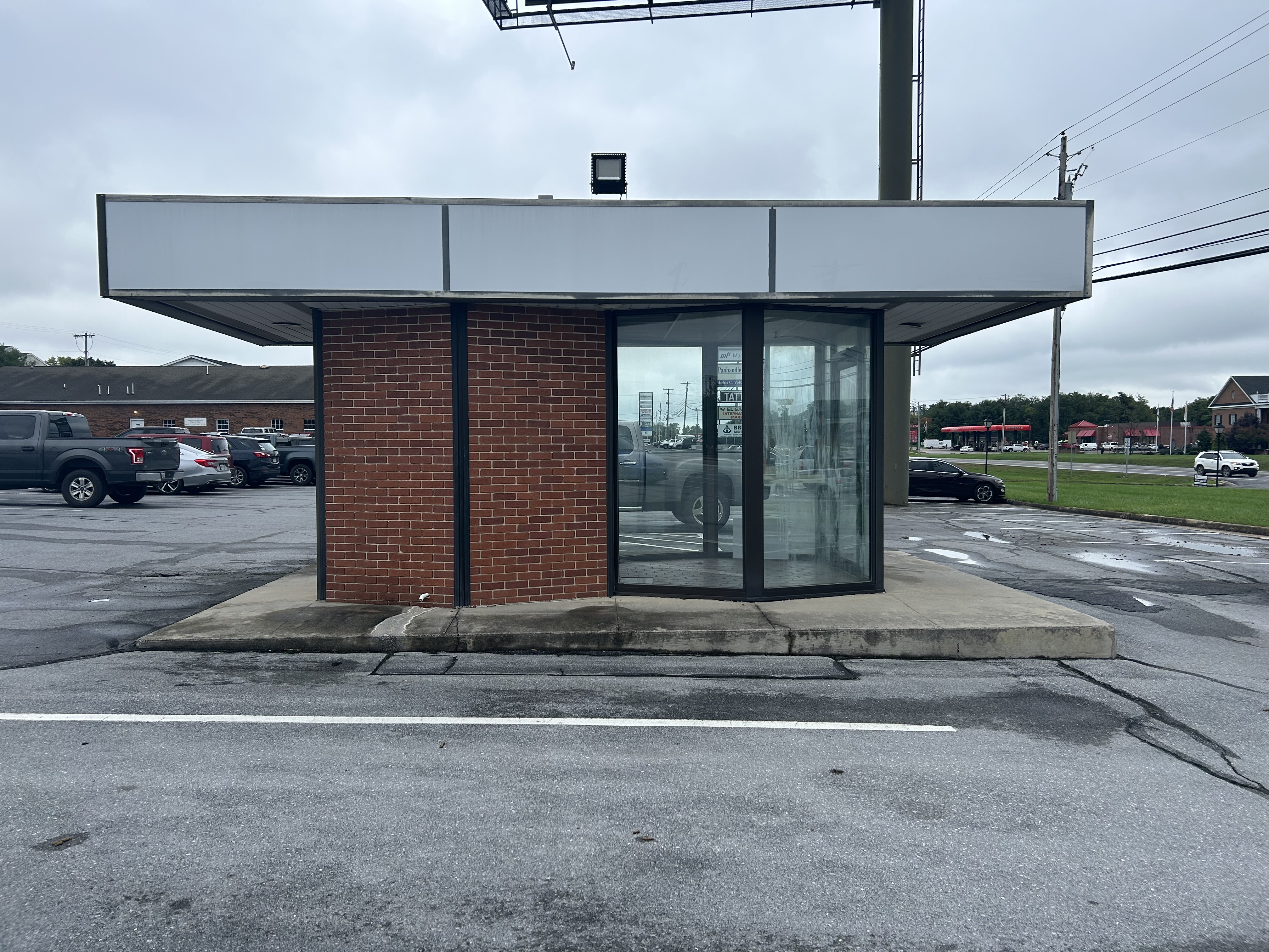

I have a customer that wants to put a large panel on the side of an old atm kiosk. The proposal he sent me would be a sign about 8' high and 12' wide, affixed to the side of the building. However the building isn't flat, it has angled sides and very little area to actually screw into. I've attached a simple sketch of what he wants, hoping for some ideas? I'm considering a banner hung from the soffit, but not sure about wind or how to secure it at the bottom. Customer is asking for a large coroplast panel, but it would have to be three 4x8s, difficult to attach. Should we build a frame of some kind? Does anyone have any suggestions? TIA

If this were my job I would build an aluminum frame using 3x3 square thin wall aluminum. secure bottom to concrete with about 5-3/4 x 10" titan HD masonry screws and attach top to existing fascia of building IMO that would be just fine and be secure

To answer everyone's replies - This is an old atm kiosk, and my client is a furniture company that has their main building behind this shopping center. We will be putting directionals on the overhead panels, that's no problem at all. My client wants in addition to that a large billboard photo to attract attention from the main road in front of the kiosk. There's just no really good way to secure it, and I'm kind of at a loss as to how in the world I'd make this work.
I think visual800 is probably correct, I'm probably going to need to build some sort of frame for it.

If they want Cor-X, then they expect it to be temporary.
I'd run some 12'pcs 2" x 6" across the high points, then attach your Cor-X to that. If they want it longer lasting, make it 6mm acm panels.

Something that anchors into the ground is best, as Visual800 suggested. As for anchoring something into the "high points", that might work OK on the brick side, but I would be very leery to attach to the frame of the window side. Stress on the frame could crack the glass.
