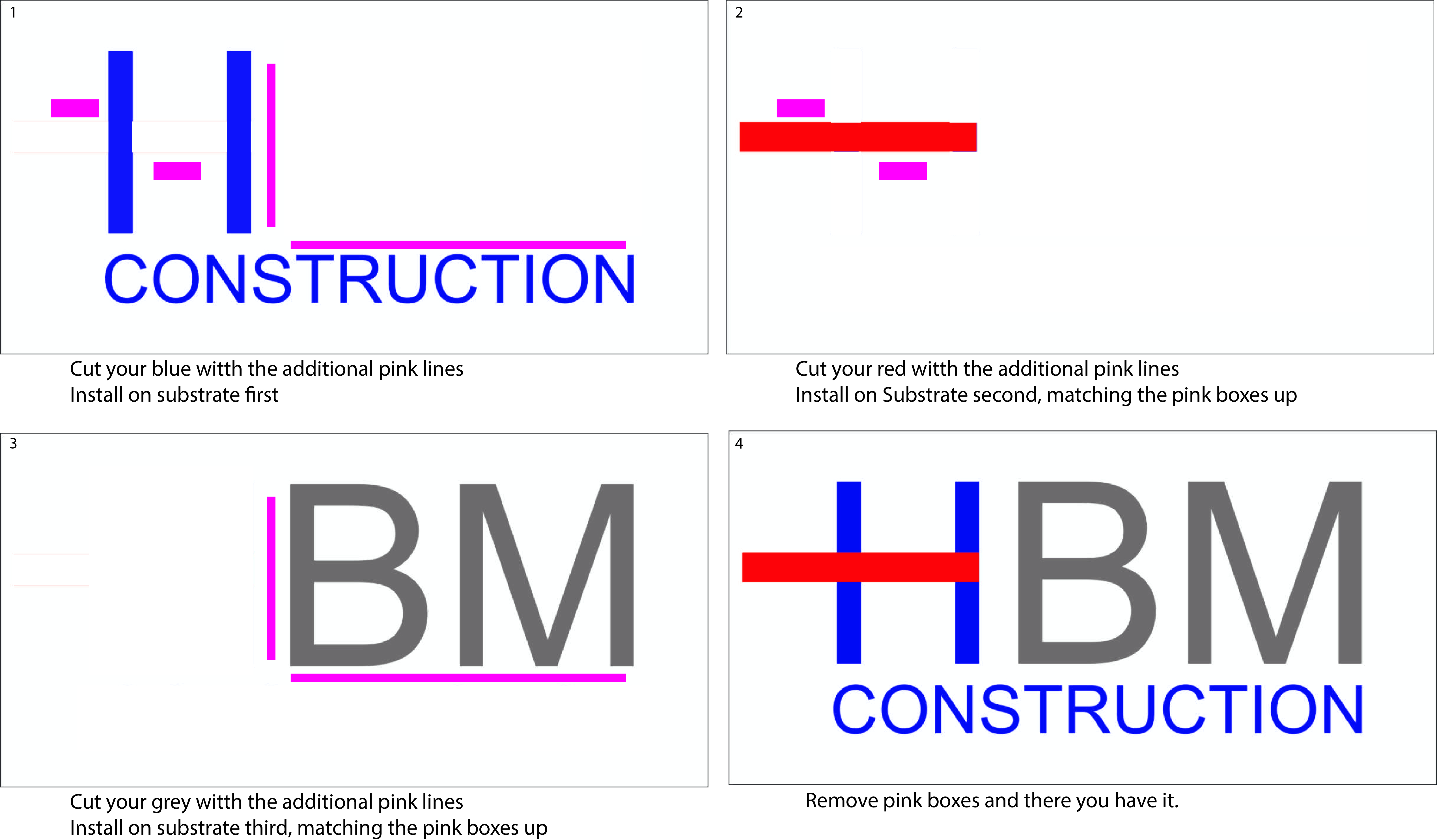

I'll make this super simple for you. Use three different colors of cut vinyl. Preferably a cast vinyl. Then setup the file with layers and registration boxes. When you setup your registration boxes don't move any of your artwork or boxes. I usually put each color on it's own layer and the registration boxes on another layer and then I can choose which color and boxes I want.
s!AgAfPAiGmL8mh78uoWT_mYZB0hcyeg
