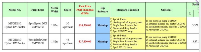

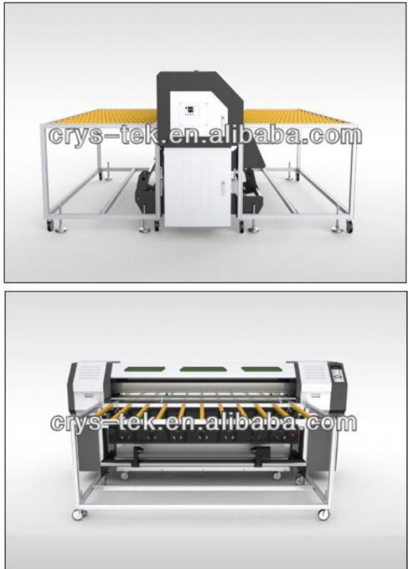

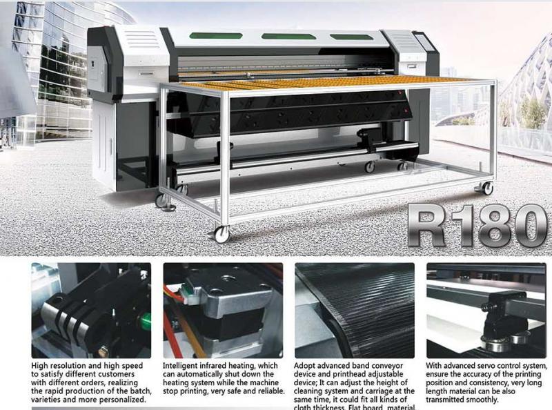

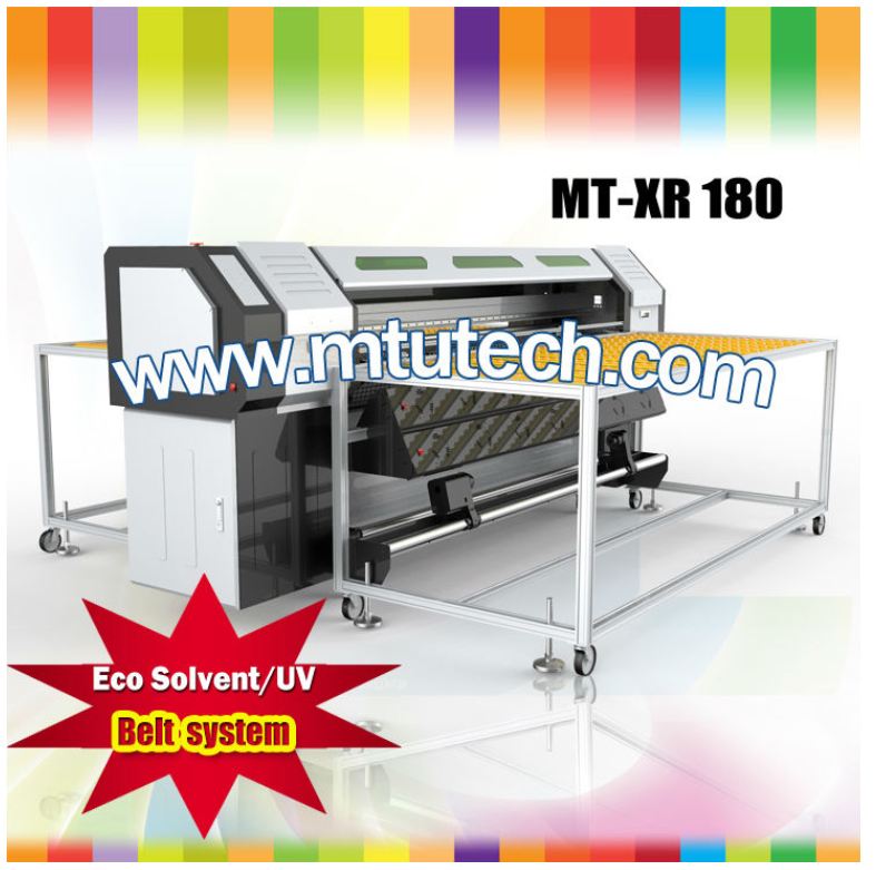

this flatbed printer costs $28,000 and this CMYKW using Ricoh. i believe meitu tech is the original designer and is licensing the build to maybe five or six other builders. dual dx5 costs $16,500.
