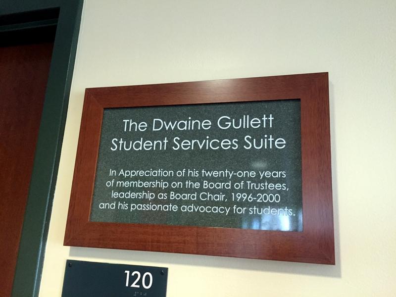

Anyone run across engraved signs like this before. I'm assuming these are laser engraved. Not positive but I think the face material is possibly a granite? It's definitely a stone material.
P.S. the size is 12s" x 18"

Oh that looks like milled PVC with some kind of marble veneer/skin on it. This is also seen with stainless steel plates as a facing that has been milled in to a PVC substrate. I'm sorry but I can't remember who we used under Distributor Central. You would just setup a vector file essentially.
d fleming
I get granite tiles from HD and blast them with spot gun from harbor freight then paint before removing stencil after blast. Trim out however you want.
