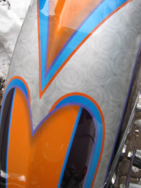

My friend is a Top airbrush artist, 'has figured several times in biggest airbrush / bikes magazines across canada - USA... a living legend! He's actually getting a very special request he couldn't handle alone. As we work together quite often on jobs, he has decided to put the pressure on me for this particular one. A customer showed up at his shop to get accessories painted (hardcase saddlebags & fairing) to match his special edition bike. Usually he's skilled enough to recreate about anything textured or special colors but this one is a PITA. I'm also the kinda guy who always found a way to reach my goals but I'm so overloaded that my brain is completely OFF at the moment. The only part we have to recreate the pattern is front fender which is all in curves so a scan is nearly impossible (?)
He will do the design (colors) but 'needs the background printed and applied on the jobber parts. To get the silver metallic color, I'll have to print on cast silver material (which I already did few times successfully) but how the hell can we recreate the swirls pattern on Photoshop?

I thought 'bout something like that but as the saddlebags will be mounted 1" away on each side of rear fender, the pattern has to fit in size, color and subtilities of the pattern itself. Engine turn also has overlapping pattern which hide a part of each "circle", the actual design is different because the circle are almost complete, just touching each other on 4 sides.
I've decided the ask the pros here in case someone already met a similar challenge. One thing is sure, this has been printed, not airbrushed directly on the parts. There's no way you can spray this pattern evenly everywhere on tank, fenders, side covers... It has to be printed so in fact, THERE'S A WAY TO DO IT. As I'm not an expert in Photoshop, maybe there's some tricks I haven't mastered yet with tolls provided (like brush pattern)

I was thinking engine turn as well. So you say engine turn wont work well try this. Take engine turn in to what every program you use and redraw just one turn then make copies and have 4 then turn it into a pattern and there you go. It will require some trial and error on the drawing part but should work out. Also you could use photoshop ccut out the overlapping turns and fill with slices of turn design and clean it up a little and then make a pattern. Also take pic of original design and get to work in photoshop it can be reproduced just wont be fun hope your getting good pay as it may be a real pain to do.

Looks to me like a round piece of scotch brite spun into a silver base coat.
Are all the circles exactly the same? If so then maybe it is printed. Build the pattern in PS and blur it, turn the fill opacity down and layer it up.

That is not even close to engine turned. If I had to replicate this I would zoom in on about 3 or 4 with camera and redo the art is flexi and pull it over to illustrator and finish it up. close would get you by on this. It doesnt appear to be that big of a deal actually. I kinda dig it

I only got this pic by email from my friend. Maybe with real piece in hands I would find my way to do it but by asking fellow members here, I thought maybe someone would have a clue on how this design has been created at first (plug-in or whatever it may be).
If we had to recreate this paint scheme for another bike, yes, I would be able to do something within the same ballpark but mounting parts next to the originals put the challenge at another level.
