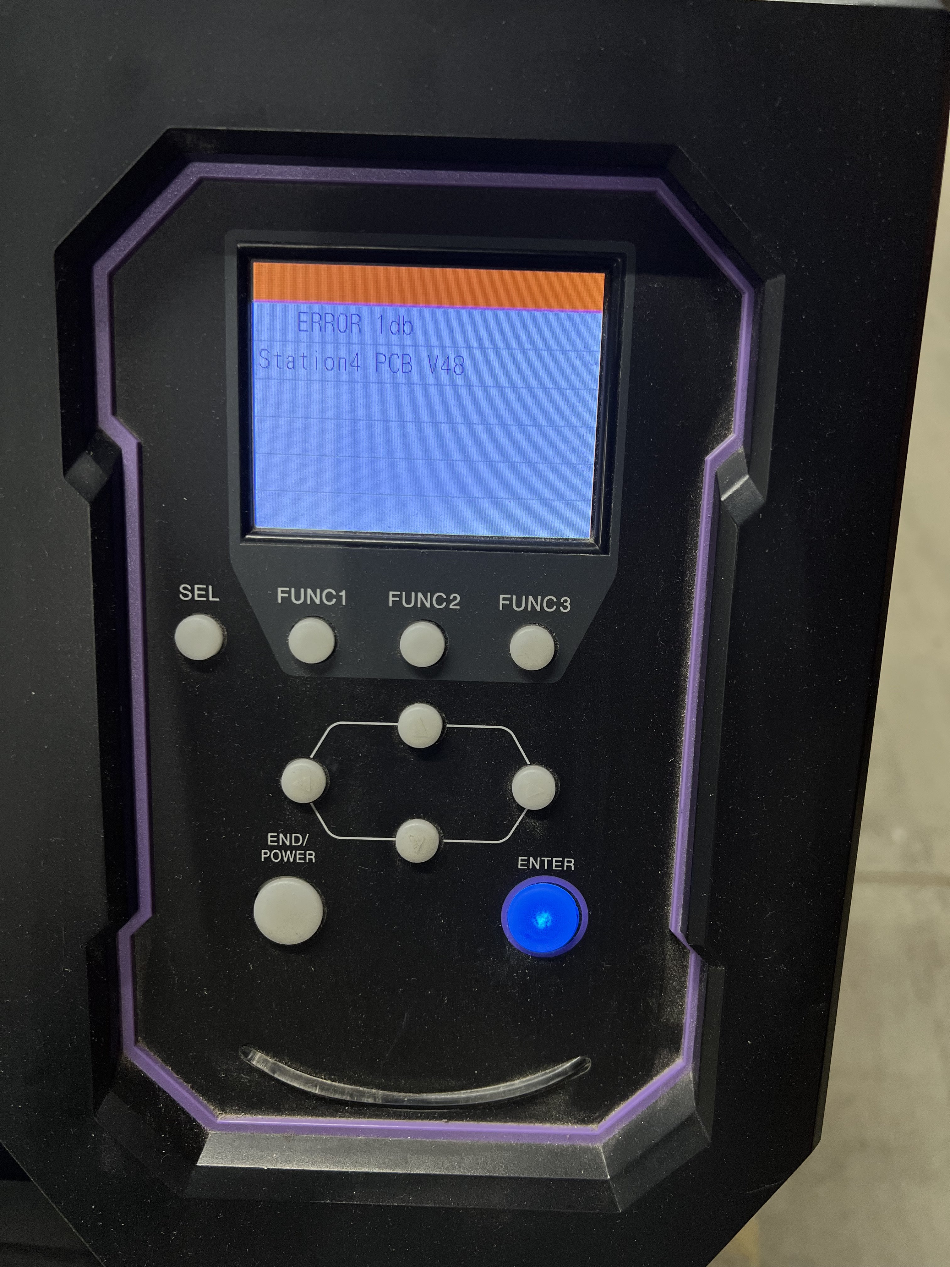

Here is a screenshot of the error on the printer. They said this happen recently when trying to power up and run a head test to sell the printer. Looking it up, points to powersupply. Have you ever had any experience with this error, and any thoughts now how bad it could be to diagnose and in repair costs.
Smoke_Jaguar
Could be that, or the board might be damaged. Main voltage being off will get a voltage error for other systems as well.

Thank you for taking so much time to keep responding. I apologize for repeatedly asking more questions. Looking at the manual you sent, it looks like there are 3 steps noted for this error. Step 2 is testing the power supply, and then step 3 says replace all theree PCB's at once! That sounds pretty bad. When it says 1, 2, 3 ...etc. Does that mean you must do all of those steps to complete a repair, or does it mean it could be one or the other.
Curious if you've ever seen this error and if it's likely that all those boards failed and going to have to be replaced? Looking like that will add up significantly.
- Also, are there ways to source boards and parts like this at a reasonable price, or am I likely looking at full Mimaki prices on spare parts.
- And is it best to post each issue as a new post? For example the 1db error could involve many things, Should I post that as its own post so members see that as a specific issue, and then see various solutions that might work / have worked for different people.
Thank you

Do the easy/cheap steps first. And make sure when disconnecting anything to document where it went carefully. Snap a photo or whatever. Plugging a cable into the wrong port can lead to a ton of troubleshooting hell. If the printer was running when it was turned off, likely to be something simple. Also, most boards have small fuses clipped or soldered into the board, make sure to check them all on each suspect board with a meter.

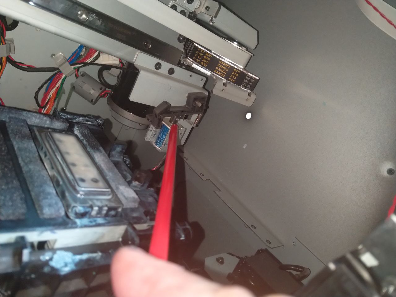

Is the way to unlock the main printhead carriage so you can safely slide it away from the capping station while the machine is off?
I currently cannot fully boot up due to the 1db error.
Smoke_Jaguar
There is a latch on the right side of the print carriage, but you will need to remove the top right panel to gently push a long pointy thingy in to release the latch.

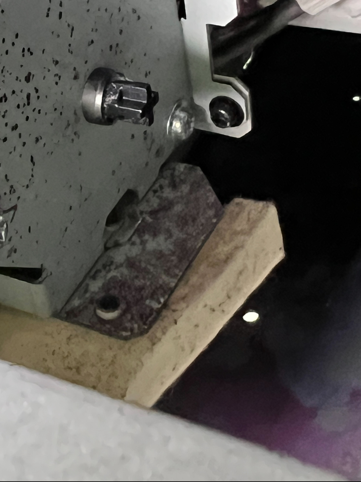

As I go thru the machine physical cleanup, is it safe to manually turn items like pumps, motors, etc. For example there is what looks like a shaft protruding to fit some tool on this pump. I want to check for anything that may be seized with cured ink, or possible points of leaks, etc.
- Can that shaft sticking out be used to rotate it.?
- Any concerns clockwise / counterclockwise?
Thank you

HGdesign
Nope, this latch here holds the head.
The picture I posted was referring to the note posted with it about rotating the pumps, etc. safely. Did the text not show with the image?
Thank you for the latch info. I was able to locate that and have been able to slide the head over successfully.
Smoke_Jaguar
Ahh, as for manually rotating the pumps, you can do it, not going to harm anything. Just beware of pinch points. Just the image showed on my phone.
