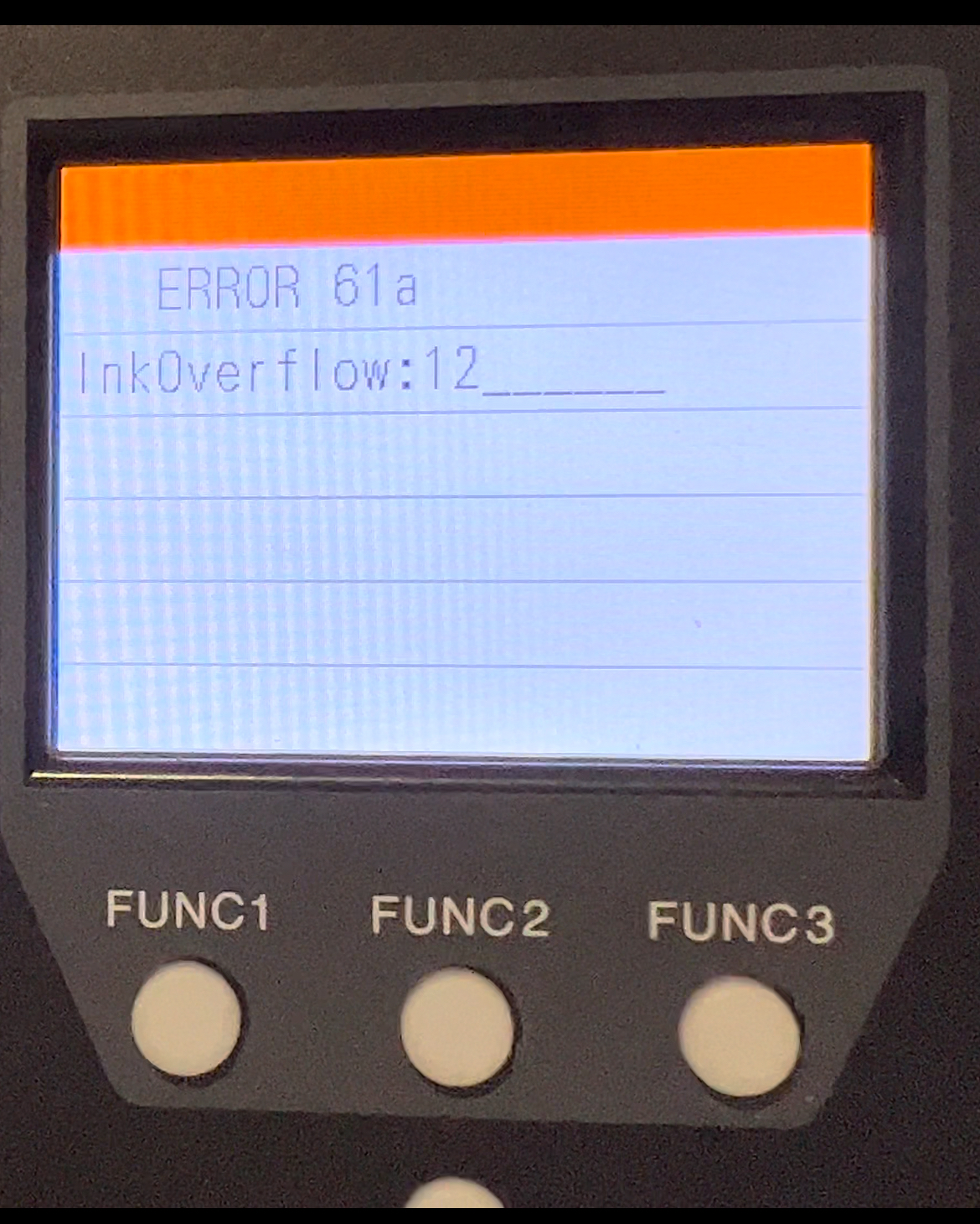

- The bad news is now I got an ERROR 61Aa InkOverflow on Cyan and Magenta.

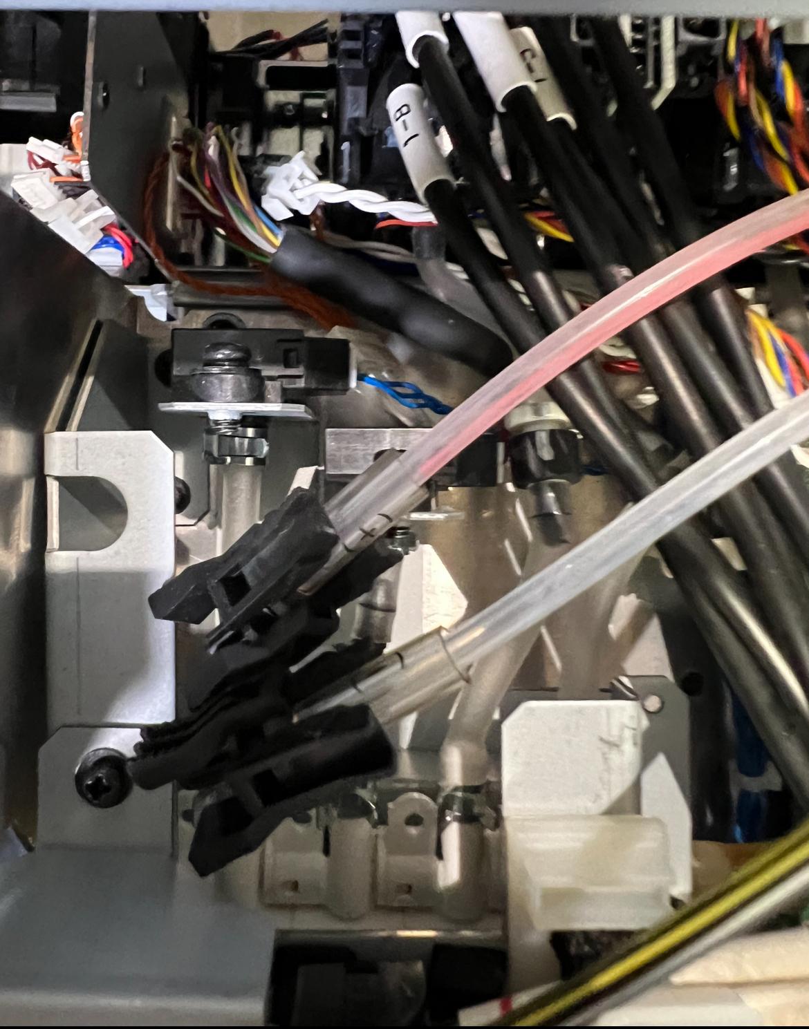

- Visually checked the + / - Air lines above the subtank area. They look visually clean ( see photo)
- Tried maintenance / Overflow 3 times and error is still there.
- When I do the Overflow function, sounds like the waste ink pump is trying to get ink out, but I do not see more than a few drops of ink fall into the waste tank.
- When I look carefully, I think I see an air gap between the head and the capping station during that function. So I guess it's not trying to create any suction, just gravity dripping any ink out of head?
Please let me know your suggestions for this error. So sorry, I keep asking for help with one error after another.

Here are the photos of the top air tubes, and the error

As for the ink overflow, a common error to get when working on printer. Should clear up when lines are cleared and ink/vacuum system is up and running properly.

Will not let you do that, but can clear it with an overflow maintenance cycle. If it doesn't clear, there might be damage to the subtank.

- And is this photo of the air lines above the head the area you were recommending I inspect for ink?
Smoke_Jaguar
Air lines are fine, the color is the markings for pressure (orange) and vacuum, (blue). If your black lines are replaced and ink is able to flow to all channels, discharge and refill the subtanks to see if they complete the operations properly.

I was able to use a syringe at the air purge port to gently pull a few cc of C & M ink out. That finally clears the 61a errors and the machine finally booted up without any errors for the first time. Unfortunately the error free period was short lived as I came back after a break to begin cleaning cycles and possibly print head tests, but now I ended up with Error 61b again on CMY. The K actually seems to be happy with the new line, so not sure if I'll have to swap lines on the CMY as well. I tested the ink lines for all 3 (C,M,Y) again with a syringe and pulled all the ink out and put some maintenance liquid into those lines.
