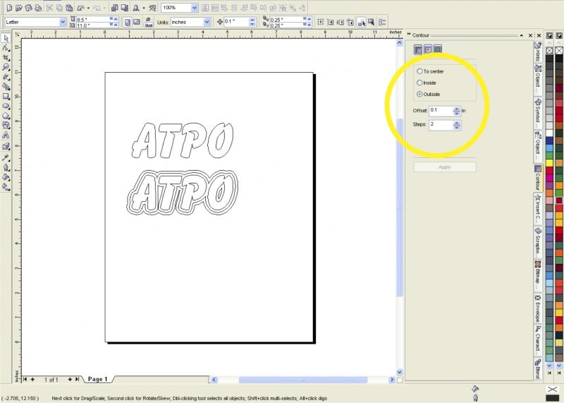

Uh, seriously? SignLab OUTLINE tool (2 passes), Corelx4 contour tool (2 passes)

actually i dont want to cut it i want to pad printed on pens but have hard time doing that outline around the big name and also i only have coreldraw x3 so no signlab no illustrator. i wish i had any of those programs but i dont at this time. So if anyone can tell me step by step in corel using the contour tool.

In corel x3...Select the lettering. choose the interactive contour cut icon in the tool menu. (looks like a bunch of boxes inside each other. Once you do this a top menu will open letting you choose how many outlines and how thick and outling color and fill color and such.

That is only an outline pen, not a vector of it. If you resize you will change the looks of it. Contour is the way to go. just seperate the contour and make the inner one white.
joeshaul
Contour with 2 steps, break contour group apart, ungroup all, then Arrange, Shaping, Combine
This will make it so the middle area is "knocked out". If you have a colored background the color will now show through on the background. If you do not want any color, you can change the middle area to white and group, however depending on what your application is, this may not be what you want (IE for pad printing if there's separations, the white may show up).
