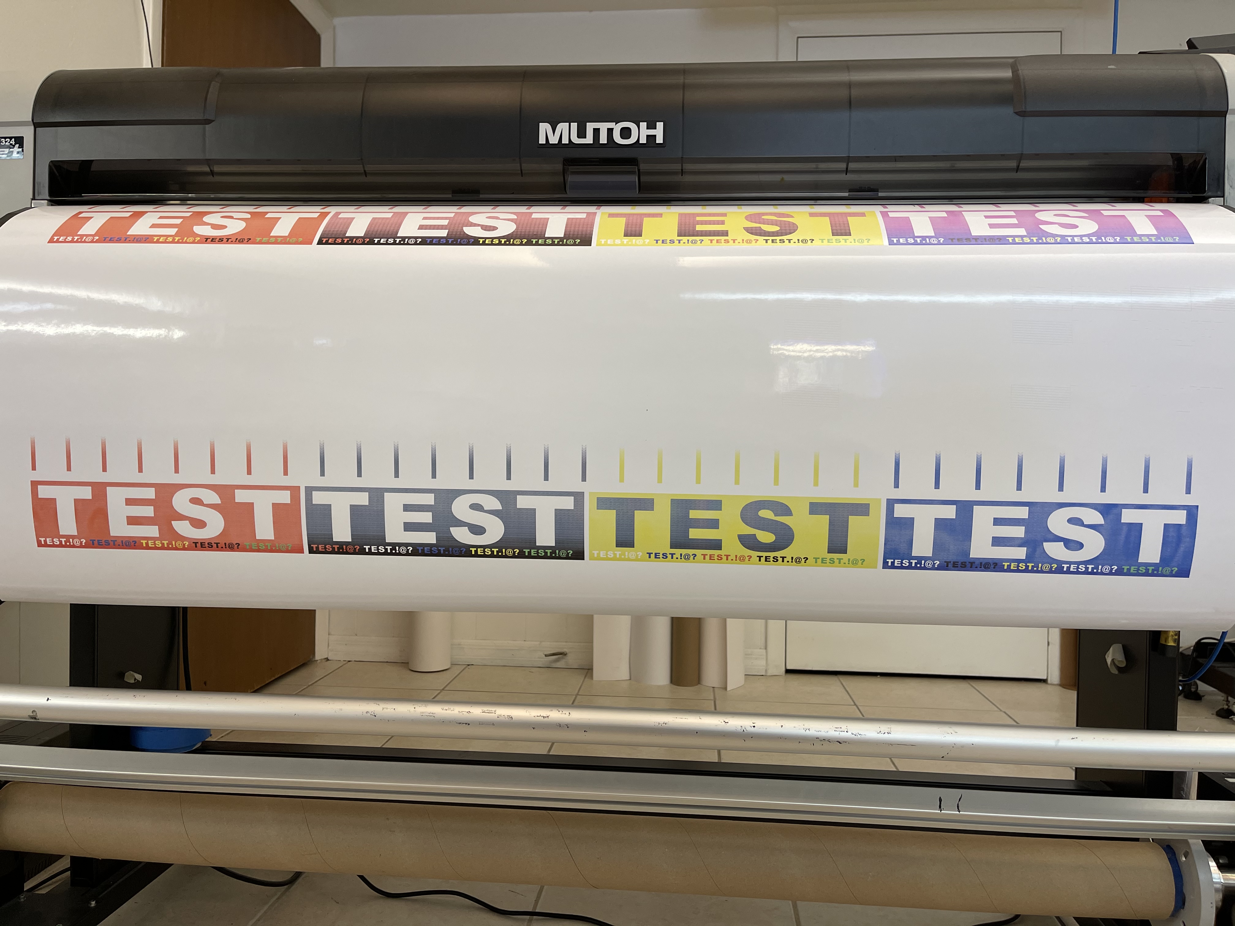

I just replaced the print head and dampers on a VJ-1324. I followed the “VJ-1324 Maintenance Manual” to the letter. The first nozzle check was perfect, an awesome sight. But subsequent nozzle checks will show missing spots and the ink flow will reduce on every color during printing. I can do a “short cleaning” and get a perfect nozzle check again. But it’s only good for the first half inch of a print.
I’m using Mutoh branded Eco Solvent Ultra ink. The DX7 print head is from Mutoh as well. The ink appeared to charge quickly when refilling the link lines after the head and dampers replacement and first nozzle check is good, so I don’t suspect a problem with the maintenance station. (I do have a Lifetime Pump error though.)

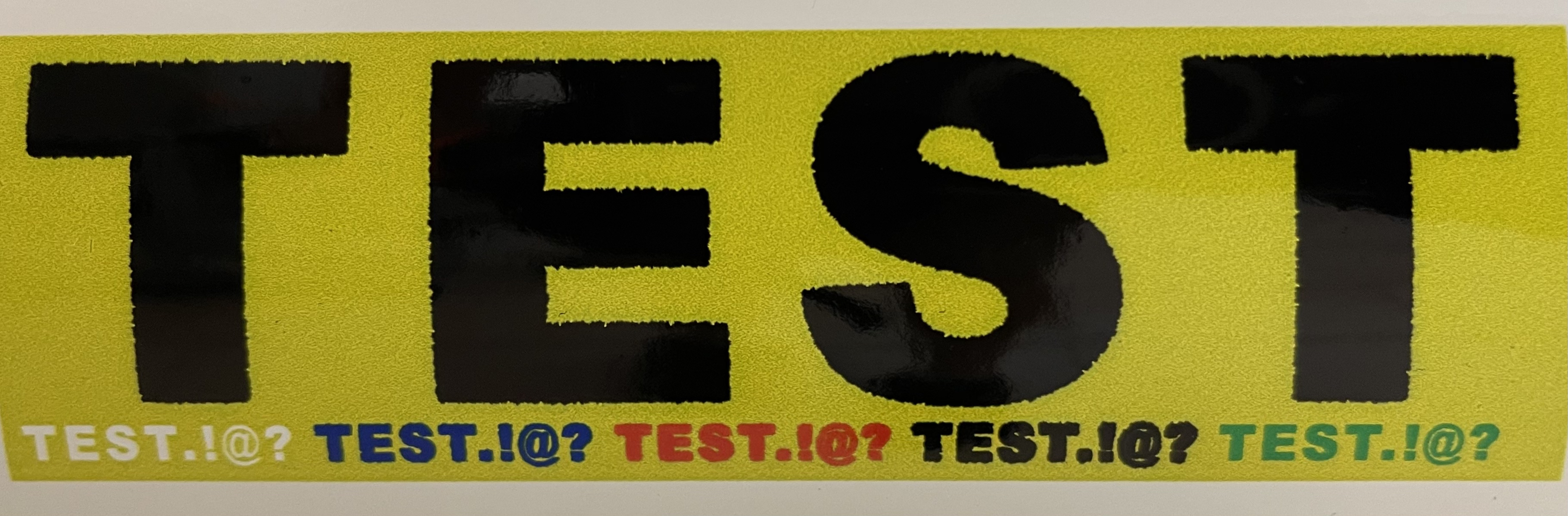

I attached a photo of a test print to indicate the issue. Any suggestions would be greatly appreciated!

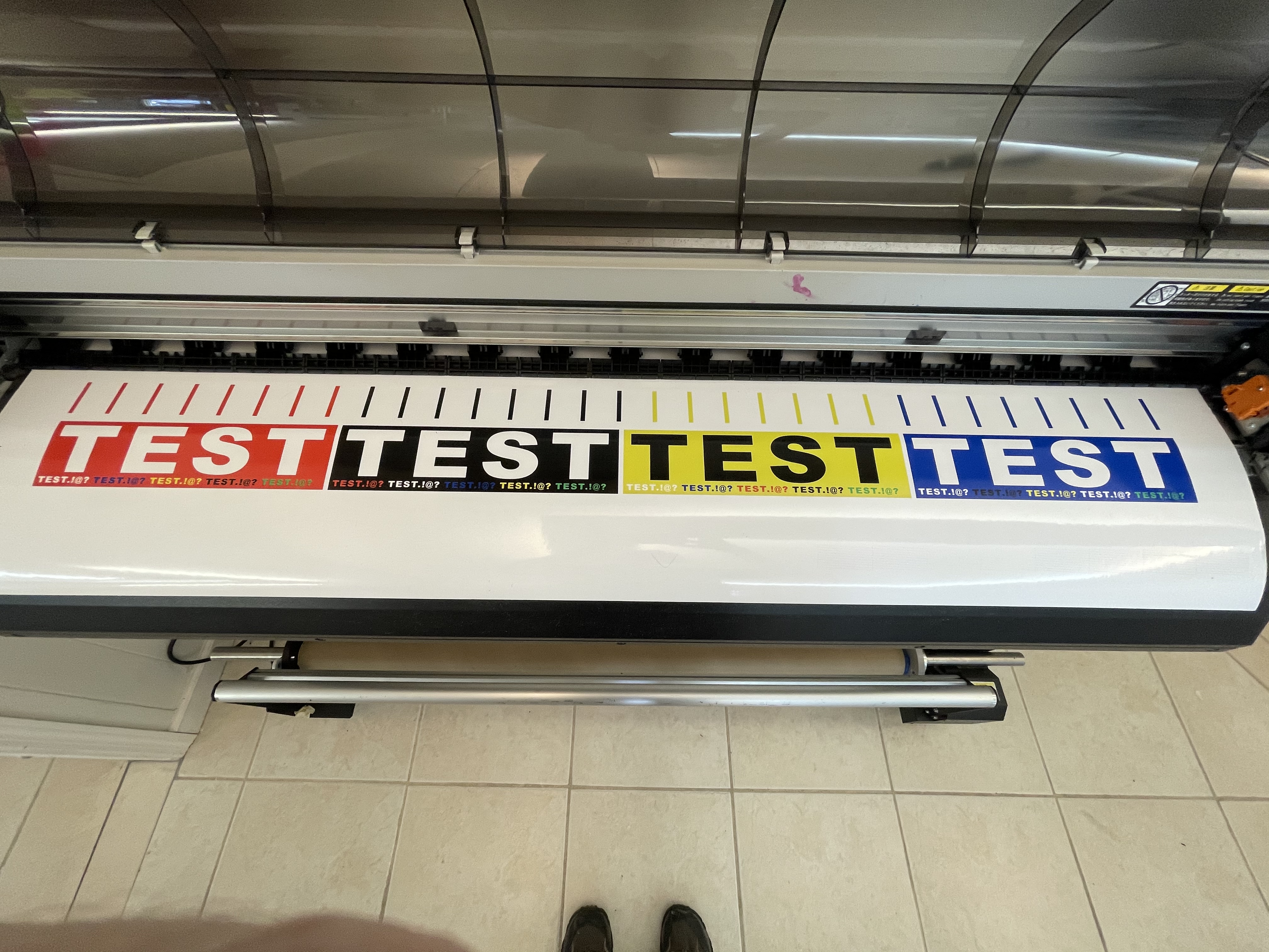

I replaced the maintenance station yesterday and I got a beautiful perfect test print. (Photo attached.)
Then this afternoon when the printer was used again for the first time since last night and it appears to be ink starving again! Where do you suggest I buy the dampers from? Do you have a link?

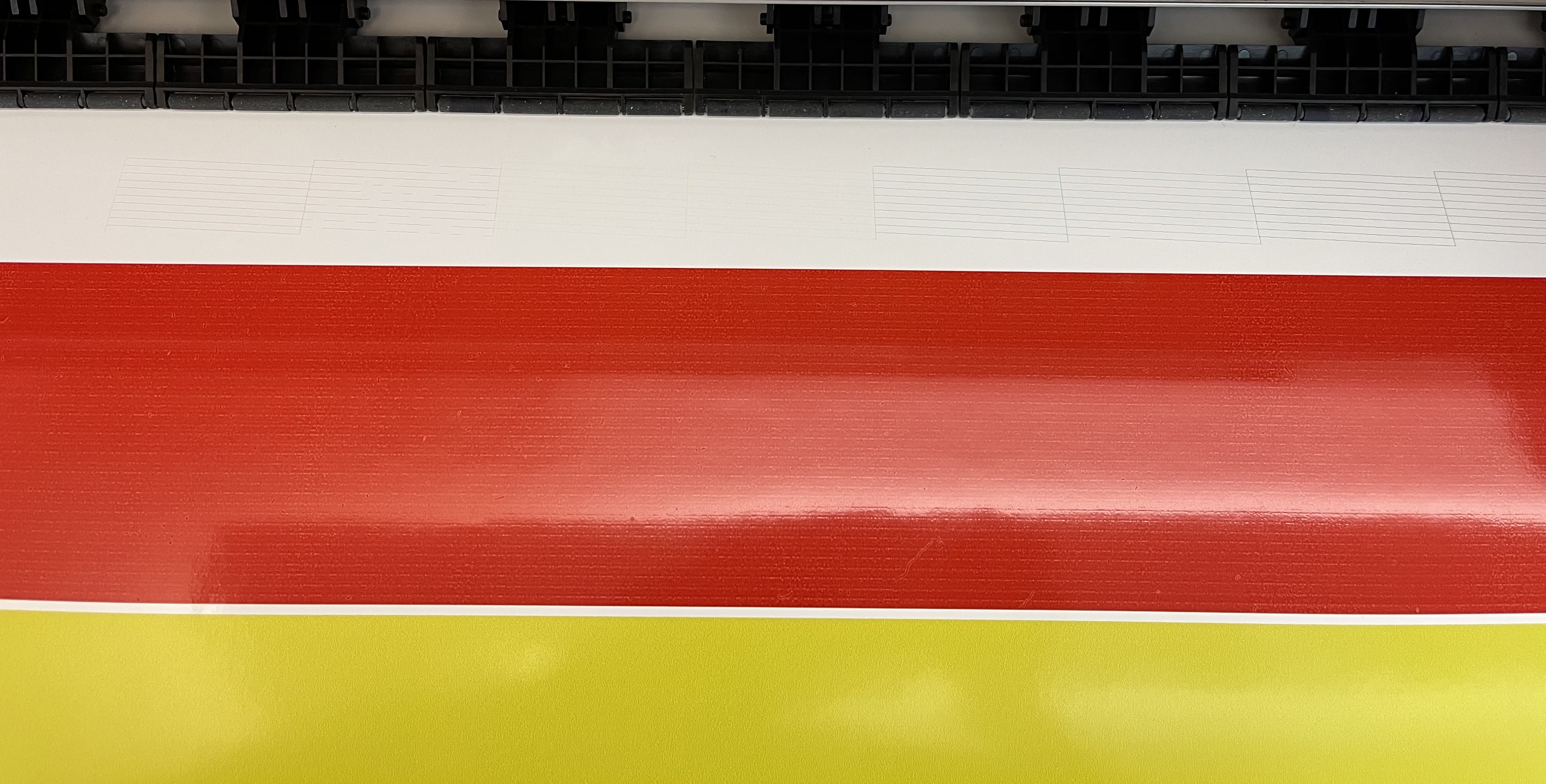

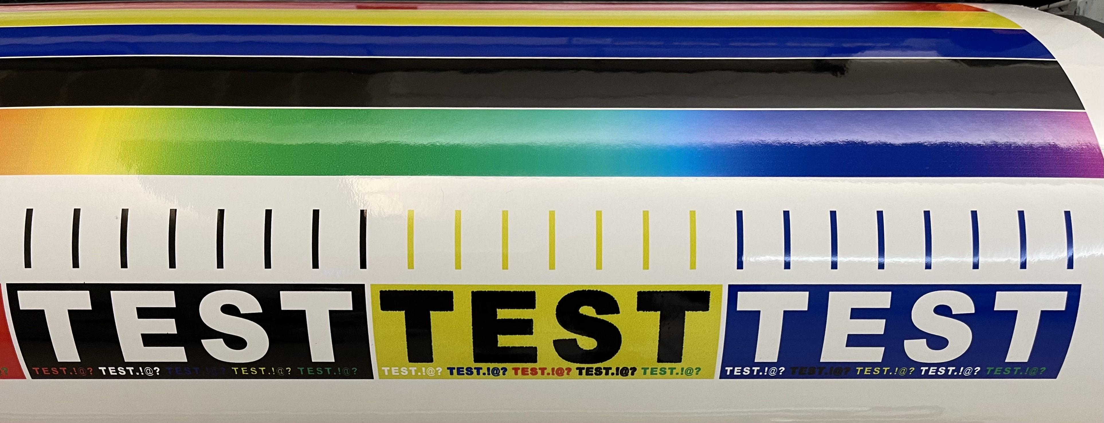

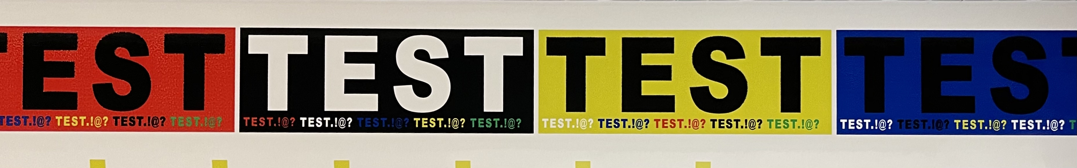

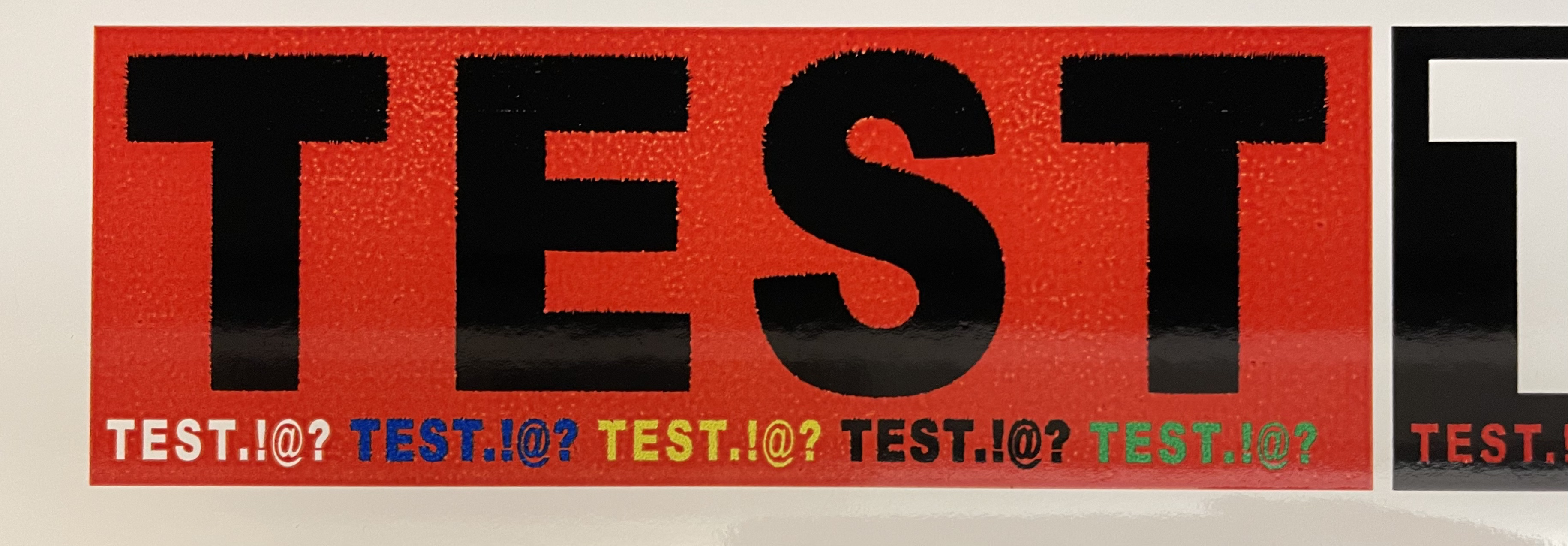

I installed the OEM Mutoh dampers and they work great! Now I have a couple different issues, the ink output seems too high, it’s bleeding on the edges of colors especially black on yellow. Also a few nozzles on one magenta row aren’t working, possibly because the head was starving for ink for a few days and the nozzles dried up? Attached are a few cropped photos that hopefully show the detail. Is the blotchiness caused by too much ink and is that remedied with the RIPing software?

Umca, thank you again! The heater temperature was always ok before, but apparently with the greater ink flow, higher temperature fixed the bleeding issue. It was an obvious fix that I didn’t think of because it was never an issue before.
Also, I get perfect nozzle checks now, the magenta nozzles cleared up on the brand new head after having bad dampers restricting the ink flow.
