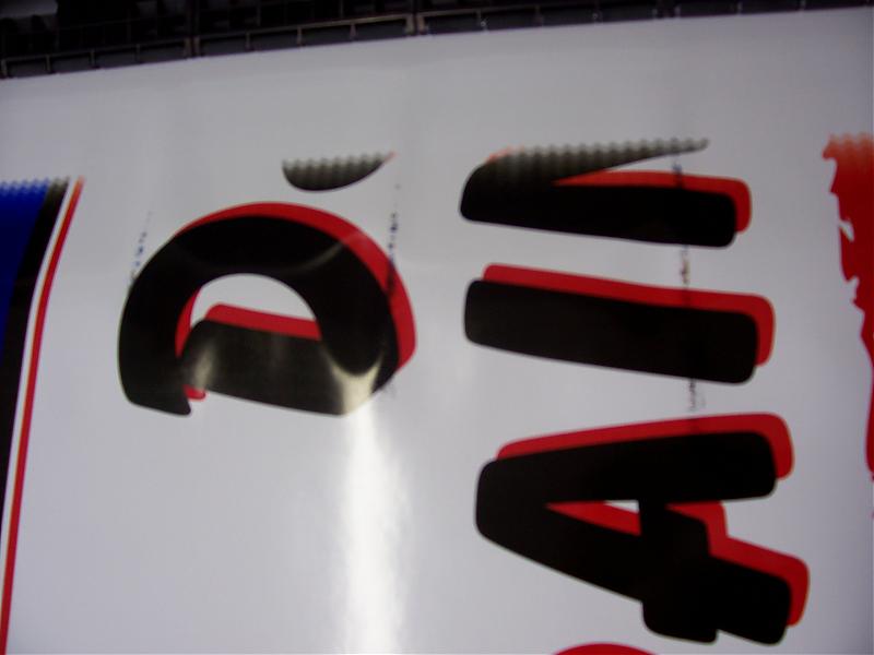

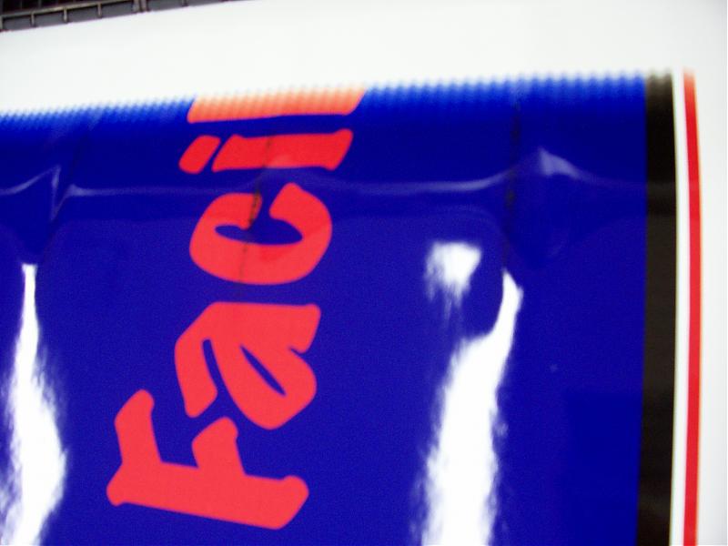

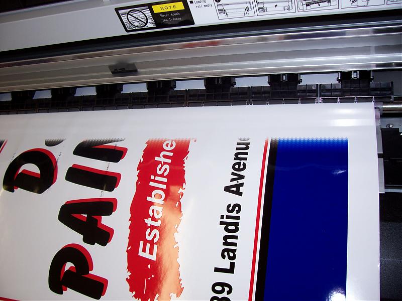

PLEASE HELP! See pics. I have a Mutoh (VJ1204 printer). I'm getting these lines on every print - only starts about 10inches in (from front) and between 5 and 12in in from the right - then they spread across the entire print at about every 5-10 inches and they are about 2-3 inches long, then it stops and the rest of the print is perfect. This happens EVERY TIME (i'm printing 8x3 and 3x3 signs for a ball field).
I did a CR Main and cleaned the wiper, replaced the pad - now it seems worse. Anyone ... please let me know any suggestions. This job needs to be completed today.
THANKS!!
Sean

turn the heat down, if that doesn't work add something to the print before hand so you don't get the lines in your print area..
bob
Are you keeping proper tension on the media roll? Are you starting off with a loose loop in your media? You want the machine to pull the media off the roll with just a bit of tension. This keeps the media flat as it proceeds through the feed rollers. You absolutely positively don't want any slack between the media roll and the feed rollers. You want at least the minimum amount of tension that will remain fairly constant. More than that minimum serves no purpose, less than that can allow the media to buckle.
Goofball
Looks like it's definatly head strikes....maybe try letting a little more media hang down the front of your machine before you start printing...I know it's a little wasteful...but so is what's happening now.
Bob
Designer Wraps
yeah it was a combination of tension on the roll (bob) and letting it out in front (Goofball) - the combination created little "bump" in the media which made the head strike. i let it out a little more and that fixed it. Swoo - I'm glad that's all it was.
Thanks (ALL) for all your help and super quick replies - that's why I love this Forum!!
