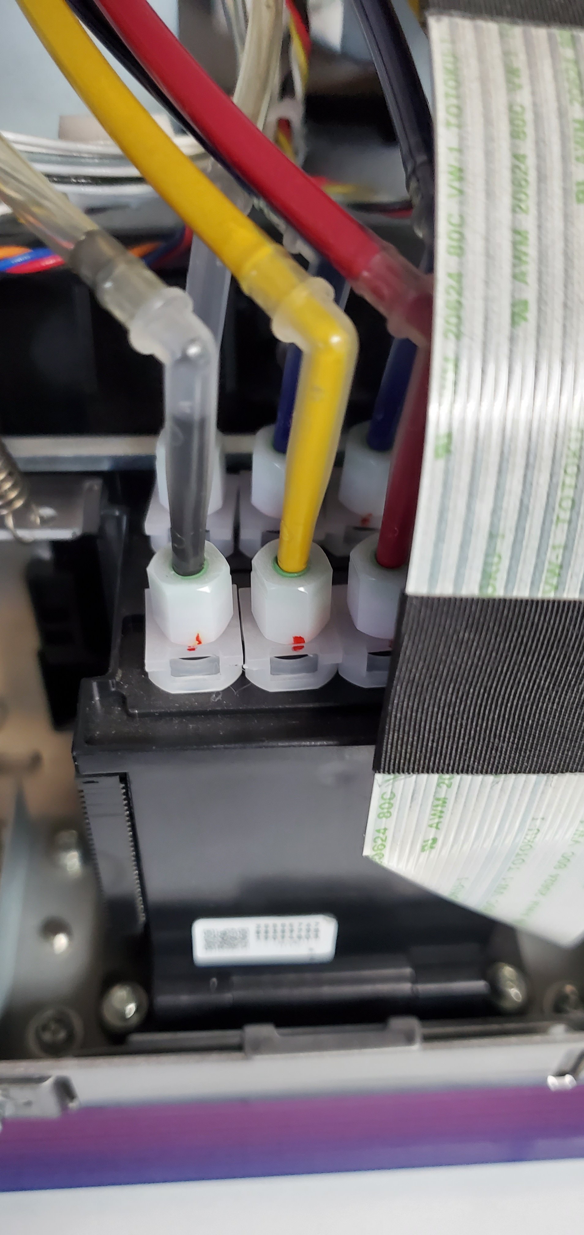

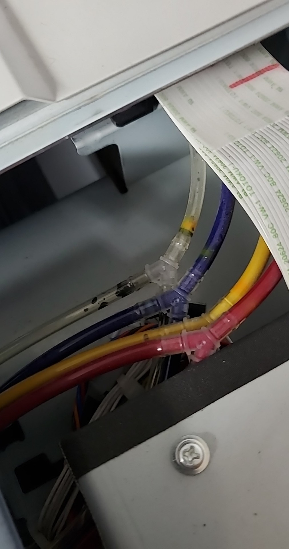

I have a Mutoh 1324VJ. I did a head wash and now there is no black ink going from the cartridge to the print head. Can anyone assist me on what could be the problem. I am not real knowledgeable and all of these threads have me utterly confused. Tried finding a service tech in my area and their aren't any. Is it possibly a damper or am I just confusing my self

Not a dumb question at all. I wish that was it the ink is brand new. The ink goes to the solenoid then half way to the print head then nothing until about 3 inches above head. Did a long clean and now just half way thru the tube then nothing else to print head. Could it be air in the line? If so how do i remedy? Hope that all makes sense and hope someone has a possible remedy.

Well, last time I replaced my head all the ink siphoned back to the cartridges, so I pulled the tubes off the dampers and used a large syringe to suck the ink back into the lines. It's a bit tricky since it splits into two lines so you must plug the one that's not connected to the syringe. Then I connected the lines back onto the dampers and had to run a dozen cleanings to get the ink coming out of the head. I've worked on my priner so much that I just leave most of the covers off. Makes cleaning and repairs much easier.

Is this the right thing that I am looking at. There are no brass screws.

Yours is the later dampers with the plastic fittings.
They should just unscrew the same.
If you have a new damper you will see it is threaded.
You can see the green 'O' ring.
