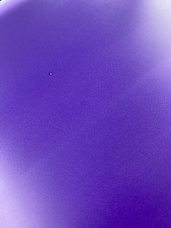

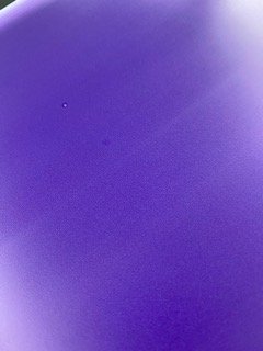

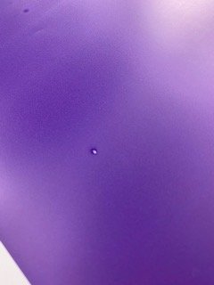

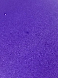

I recently had a new head and capping station installed on my CJV150-130 which is great. but im having issues printing solid colours especially purple which i didnt have prior to the new head being installed. I keep getting what i can only say is blemishes in the print on all medias from roller banner, pvc banner, polymeric vinyl (gloss and Matt) monomeric vinyl (gloss and matt) I have also printed solid blocks of CMYK and had no issues. AR|GHHHH!
I have been back to my ink supplier who recommened the enginner and I have tried everything under the sun that they have both told me to do and also changed all 8 cartridges over also and done probably upto 8 ink fill (which ive been told to do). The print test is great. however I have also noticed that when im printing black fine text its very furry round the edges which is wasnt before. Im at a loss and have already spent alot of time and money and not getting nowhere. The enginner has said theres nothing more he can do.
I have also attached images of what is happening.
Many thanks in advance
Nathan

Looks like contamination. It's either on the media or something lfet over from the tech. Since it basically purple, I'd check out your cyan and magenta channels.
dweavers
What print profile are you using, the same one for all media?
I definatley looks like media contamination or wrong print profile

Use a swab and clean around the heads. Clean your media.

Looks like drop out to me. Usually that's going to be a bad damper or bad connection between the damper and ink line. Check the ink lines for air bubbles as they are a sign there is a bad connection. Sometimes you won't see air bubbles but there's still a bad connection though.
