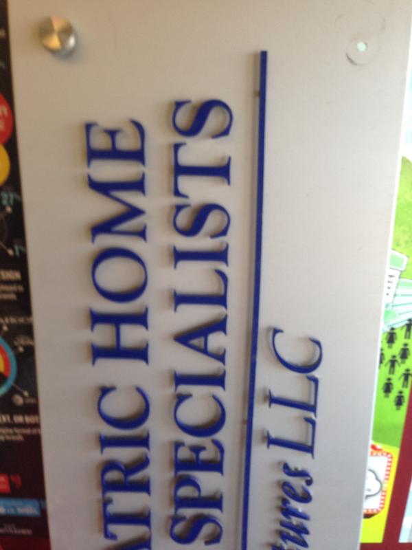

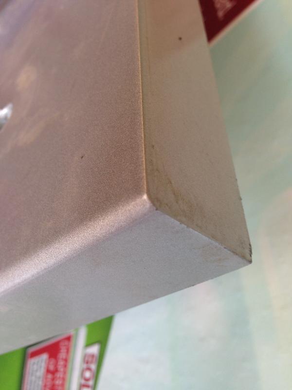

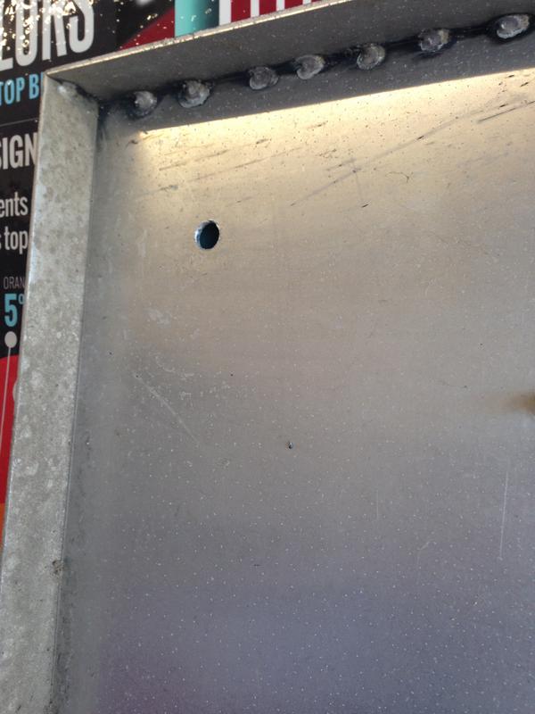

Not sure if I am using the right terms for this. Unable to source one of these so far. Here's some pictures to help you understand what am looking for. The dimensions are 1 1/2" x 2' x 6'.
If anyone knows what direction to point me it would be appreciated very much.
Thanks!

Yeah, any sign shop that does fabrication or metal shop.
Typically referred to as a pan panel, pan sign, etc.
Looks a bit cleaner if you use aluminum angle for the returns rather than brake-forming them like they did there. Aluminum angle, mitered at the corners, attached with VHB tape or Lords to a flat sheet of aluminum and you'd be in business.
