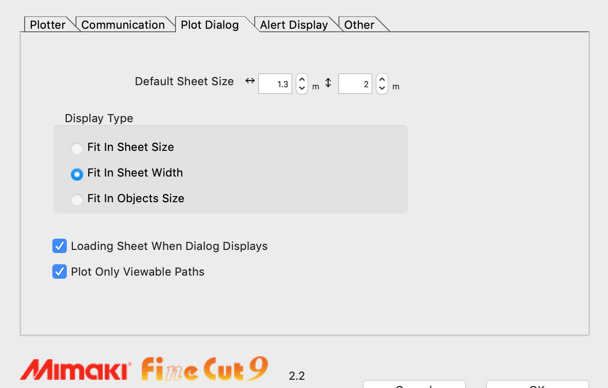

Hello. Have you checked the Plot Dialog tab?

I am using FineCut 9 for Adobe Illustrator with the same machine as yours and have no issues.
It could be with your Corel app. Best to address this with Corel or Mimaki support. Best of luck!
