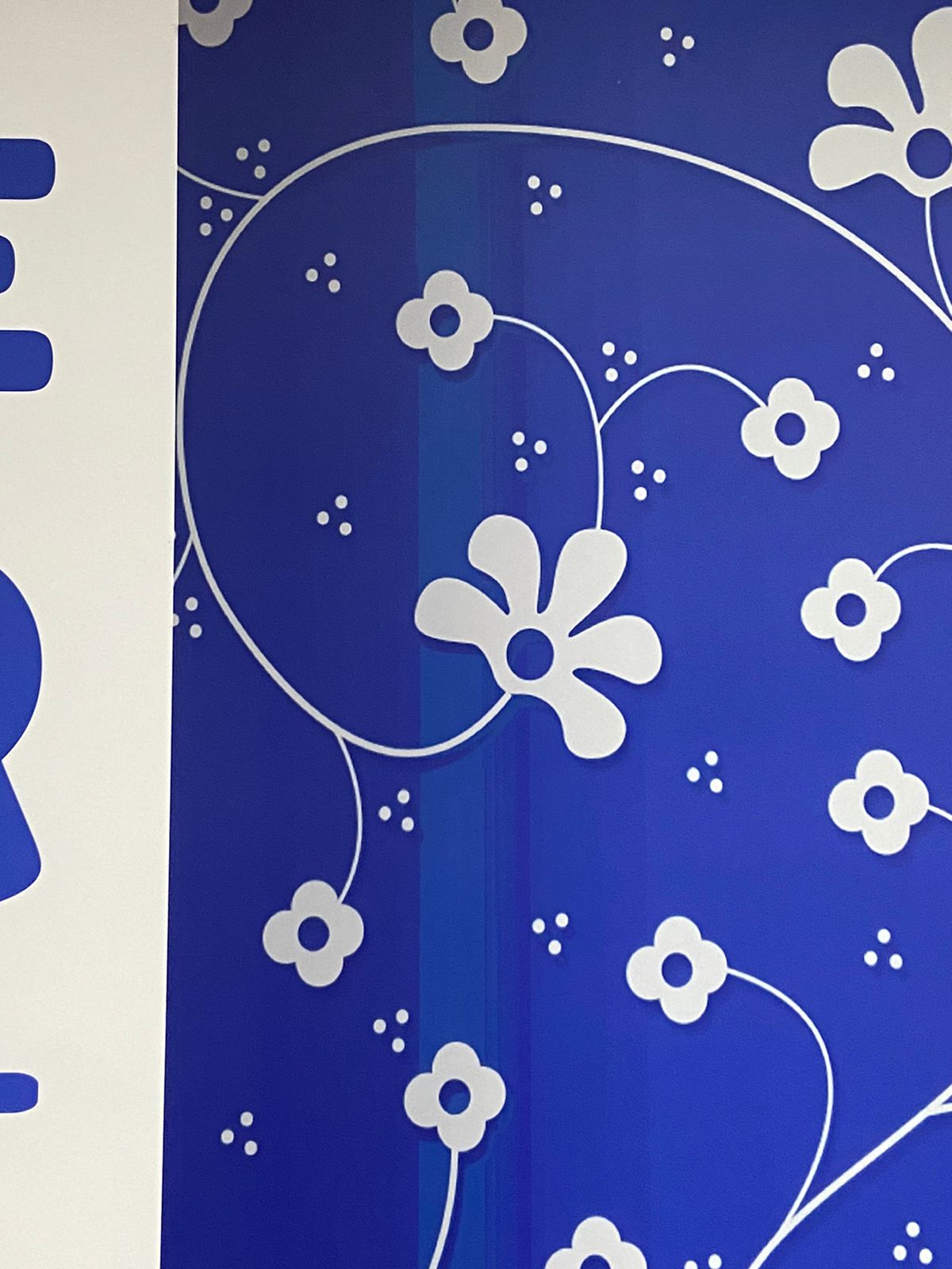

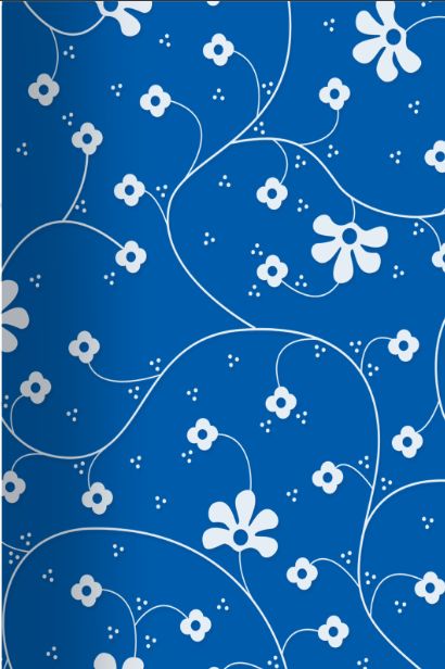

I need help with my epson printing result. Everytime I print gradient color, especially blue, purple and orange colors.
The printing result always have a distinguished lines of breaking colors instead of smooth color transitions. I already tried printing as JPG and vectors, but the results are always the same.
I'm using Onyx RIP software.
