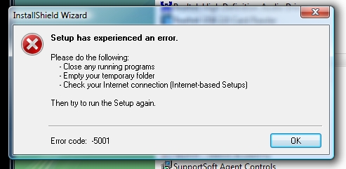

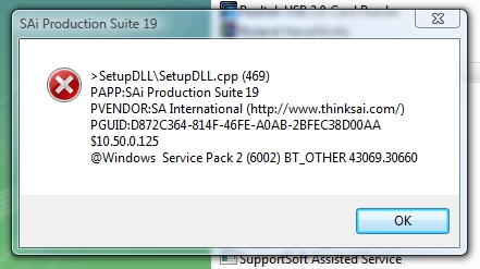

Here's the problem: I can't uninstall it. My best guess is that since it isn't compatible it didn't install correctly (completely?) and therefore can't be uninstalled.
When I go to control panel / uninstall a program and highlight it and hit "uninstall" I get the error codes shown in the first two attachments.

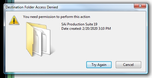

When I go to the SAi folder and just try to delete the folder I get the error message in the third attachment.

Thanks for the reply but this didn't work. I still get the exact same error messages.
