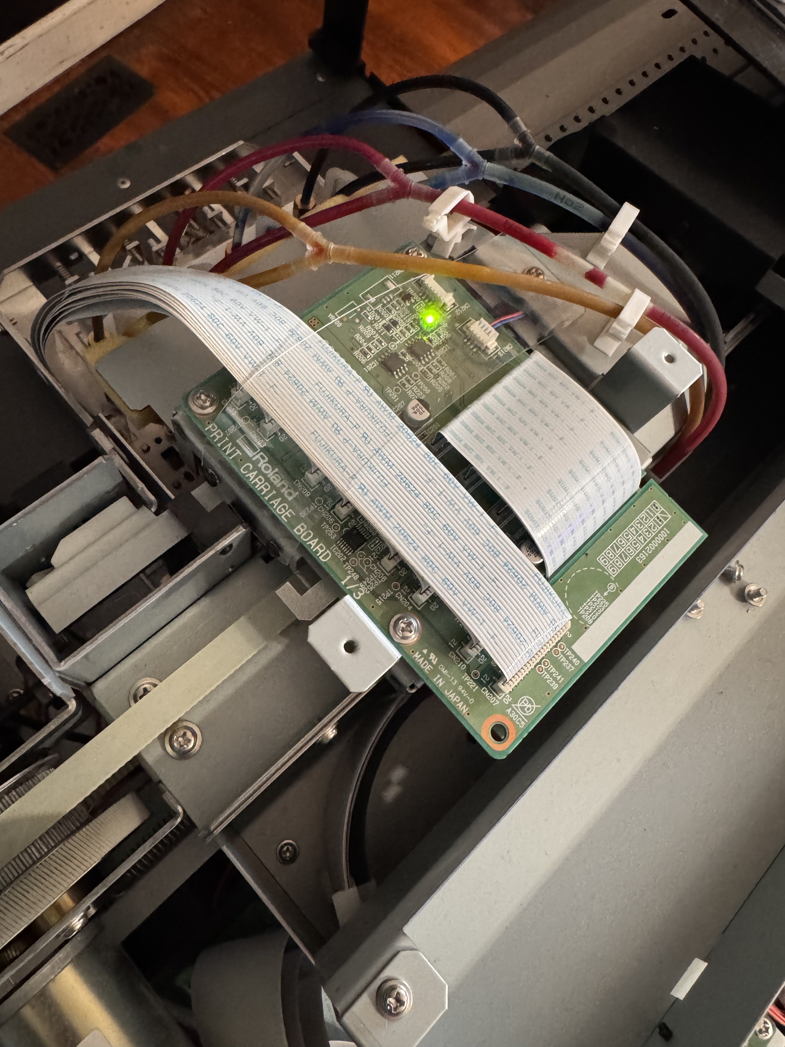

- Green Led on the Carriage illuminates

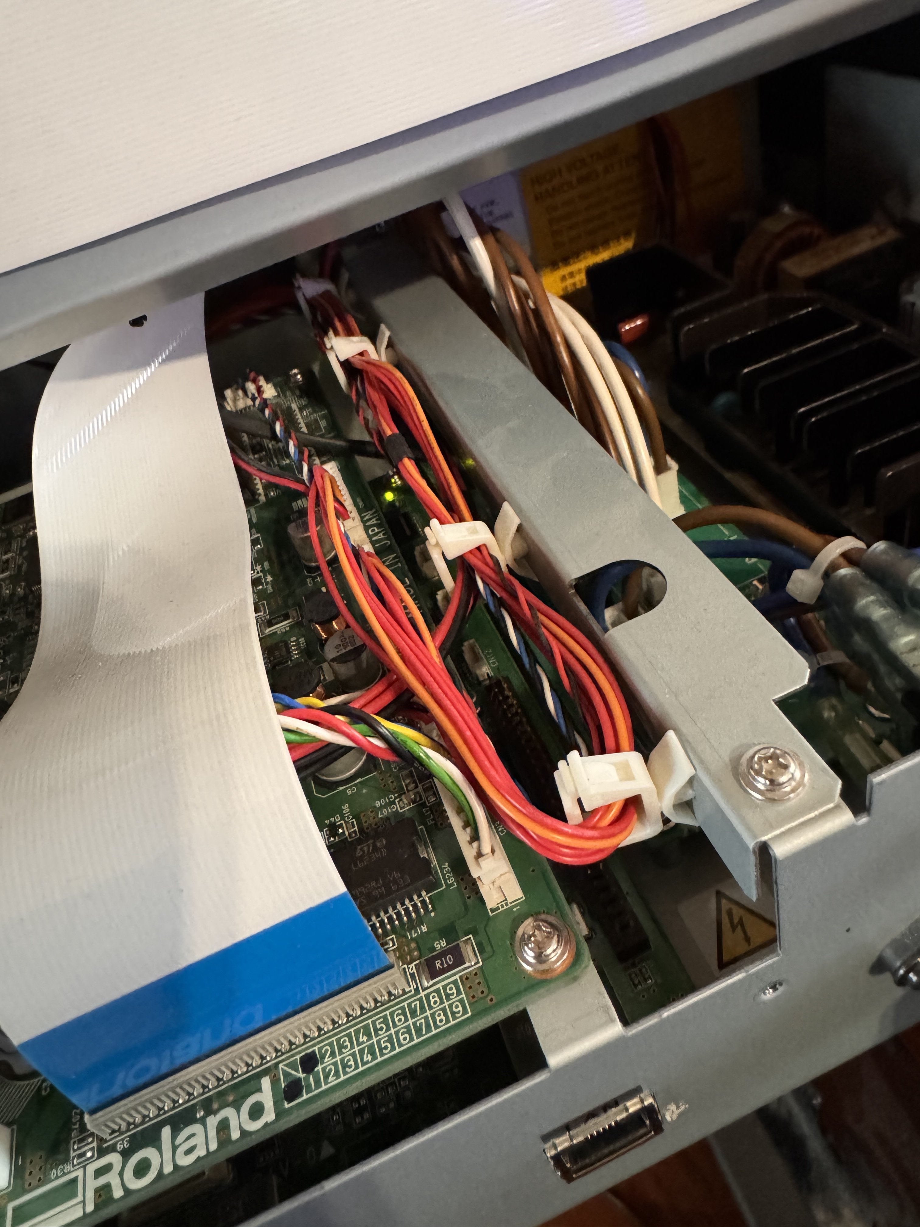

- Green LED on Main board (D1) illuminates (shown in photo)

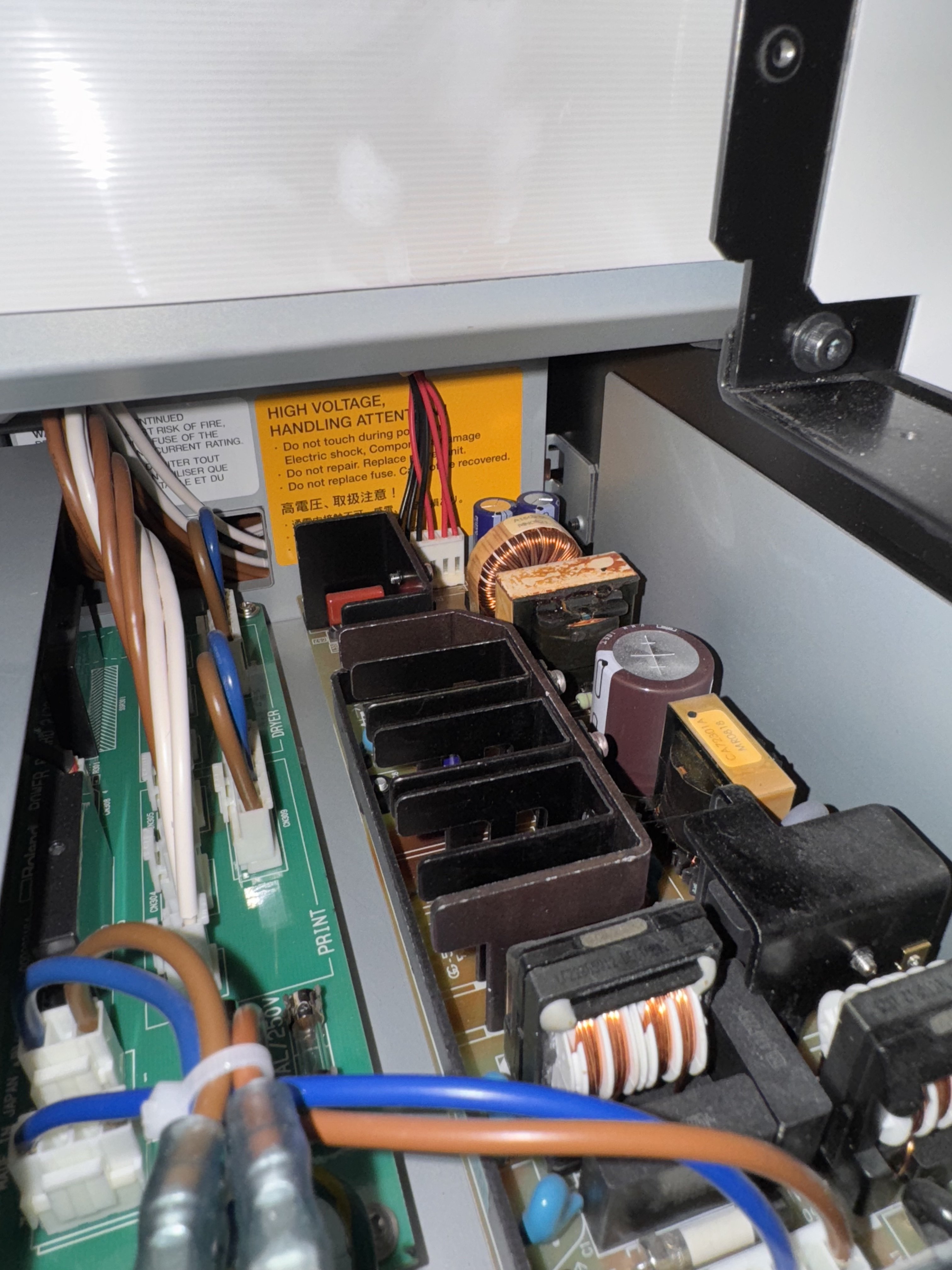

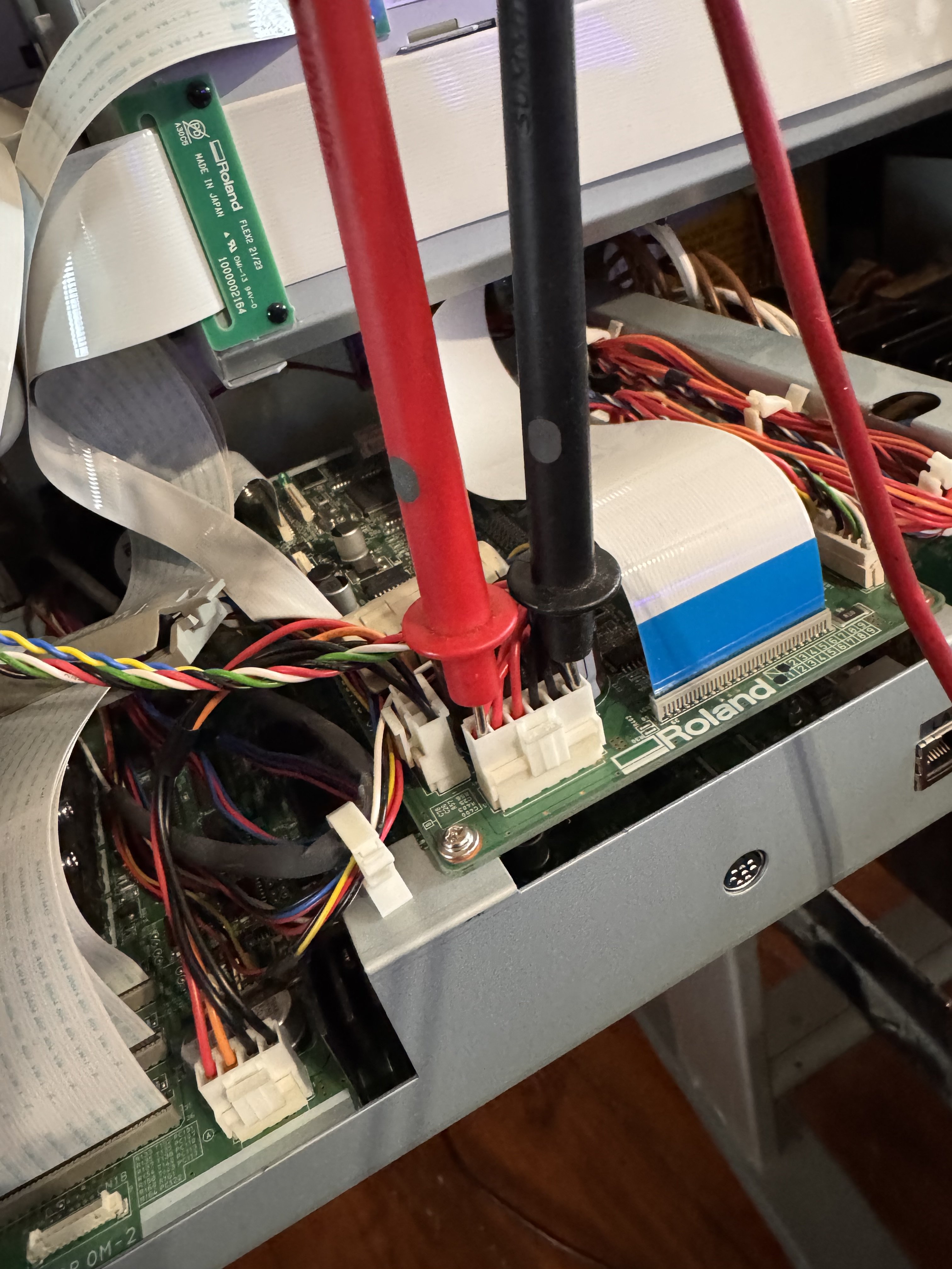

- Checked voltage from the 3 power wires leading from the power supply board to the Servo Board. (pictured)
- All show 41V
- Checked power from servo board to main board, also shows 41v.

I’m starting to lean now towards the main board, because like previously mentioned, the led that lights ups on there, labeled D1 does not consistently stay lit. Some power cycles it’s on consitantly, some it flashes and shuts off, some it barely lights and then stays off. I’m not sure that that particular LED is conveying. But it’s the only thing I can quite literally see a change in.

OK, the LED on the mainboard should stay on all the time if it is working properly
UpriseSupply
To your knowledge, what exactly is that light indicating? I’m wondering if it’s the board failing to initialize, or if the power supply may be fluctuating and affecting the main board.
