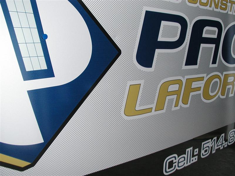

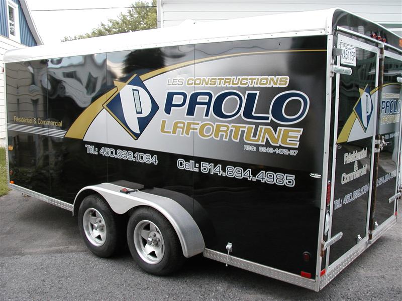

What I've found to avoid this is creating a vector gradient with dot pattern. I bought the VectoRaster software and now I can control my fighting colors' gradients. Yes, you'll see the dots but from 10ft away, it will turn perfect.
On this one, my black gradient turned "greenish" in the middle, even when printing over silver metallic film, so I recreated the dot fader in vector. From there, you can assign the exact colors you want, even dot by dot!
