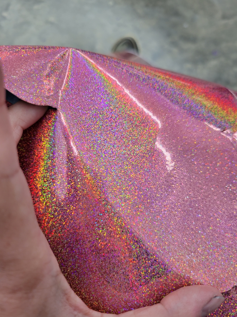

Just to update we now have a new problem with this machine. It now won't maintain downforce as it cuts and cuts through the vinyl and then not at all ruining blades and vinyl. We have jobs to be done with this weekend and we have to result to a $300 plotter off of Amazon that outperforms this Roland by far. What a disaster! If anyone has any insight on what we could do to fix before our tech gets here next Tuesday please let us know. I've attached some photos of this crap.

Did the techs do the force adjustment calibrations for the cutter? This requires a special dummy tool that replaces the blade holder and 2 different force gauges with 2 different ranges. I had a similar issue with a VG and I determined there was an issue while performing this calibration. I determined the cutter solenoid mechanism was failing, replaced it, and it has been working fine since then.

No they have not performed the force calibration but I will mention it to the tech that comes out this Tuesday. Thanks for the reply!

So to update... roland tech seems to think it is the servo board which controls the power to the cutter. We went back to factory reset and updated the firmware and it started cutting great. Now a day later it's back to square one. Can't cut again. Roland is going to remote in and try to bandaid it for us until they can come out a replace the board. Thanks to everyone for the suggestions and messages. Means alot that we are willing to help each other. Will give another update when it's finally fixed.
