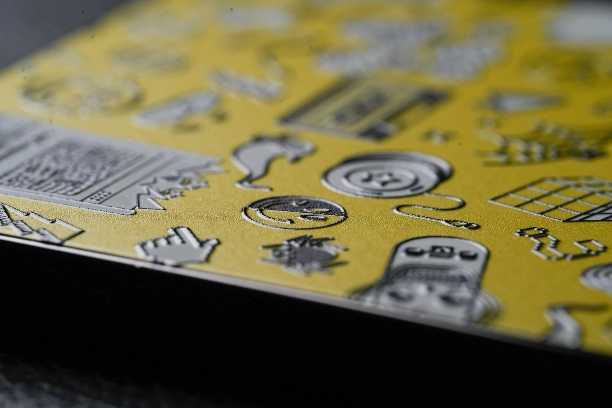

Yup, so do you use cold laminate on cast films? Man just help me out. We are launching next month and still hasn’t figured out the material yet lmao. We were using 40C but that is the worst adhesive i have ever seen. We really loved the ij180c the best adhesive so far we have seen. But the thickness of the 180c is very thin, this is the main reason why we are laminating it, to make it thicker. Here’s our product image.

When I'm laminating cast vinyl, I just don't have the heat on. I don't really understand what you are trying to do... but there is thicker vinyl out there. Ij40 is a removable adhesive. Why do you need cast vinyl, what exactly are you doing? That picture looks kinda cool, but it looks like you try to put that on a contour, it's going to crack - not to mention you won't be able to stretch it at all like you need to do when wraping a vehicle.
I don't understand what you are trying to do, or why... but layering laminate just seems unnecessary - just like printing on cast vinyl with or without laminate with UV ink is unnecessary.

If I've followed correctly, laptop/phone skins.
Have you tried anything that substance has to offer? Sounds like the TL-6100 laminate would fit the bill, especially if you can print white. It's like 6mils thick.
