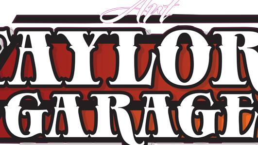

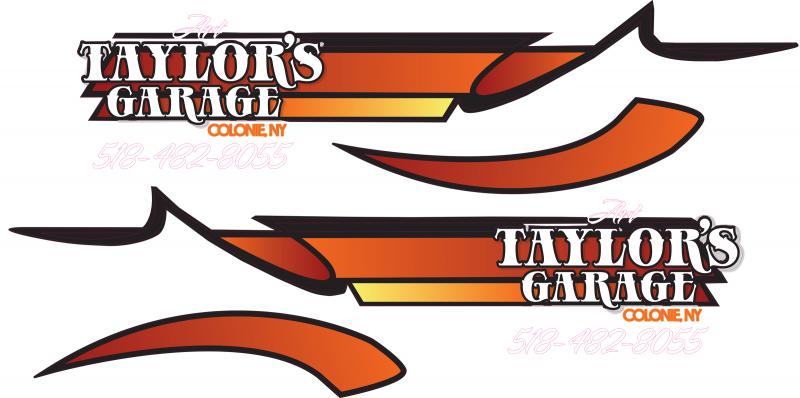

I'm having a bit of trouble with a file I am trying to print. There is a drop shadow going over some stripes and I am trying to cut as one piece on reflective. When I bring into the rip the contour cut lines are not transfering over correctly, they show up as white lines. (illustrator, versa works, roland xj540) this has happened in the past and I've had to flaten transparencies and/or move the cut line onto its own layer on top. My problem is I can't seem to flatten the shadow without getting weird stuff going on. Any thoughts or ideas to help is much appreciated.
Signed Out
here is what im working on with all my bleeds

well i can flatten just the shadow and all looks good but when i save i get the warning that says document contains artwork that requires flattening and when opened in vw the cut lines are replaced by white lines... ive tried flattening the whole thing and just somethings while messing with perserving alpha and overprints... and it seems to mess up the file the shadow starts getting lost in spots and going places its not supposed to go
Signed Out
the drop shadow isn't an effect or its already a vector... i was think about bringing to photoshop but I dont do alot of work in photoshop and i don't wanna loose the quailty of the colors
J Hill Designs
the drop shadow cant be vector...
edit: oh i see. its not like a shadow its a second set of letters opaquing up the bkgd a bit...
