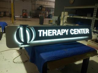

I agree with comments as stated above. ASll the push thru's we do clear or white all have a step or lip on the back to attach to the back of the face. It really does not matter how its decorated or color. We do Metal laminate on the face, Trans vinyl on the face, Opaque paint on the face and subsurface paint or vinyl. We finished this today sorry bad cell ph pic. I have some letters not installed in faces that will go out Monday if you want a pic.

looks to me like the white diffuser vinyl simply failed. Unless you can show the inside of the cabinet those pictures cant tell anyone how that router and push through face was made.
