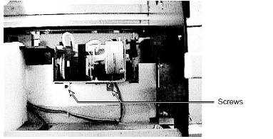

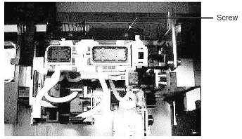

you mean just station or ?
Color Dude
Call Gei Calgraph They have these parts on hand and can get it to you quickly. It would be a Maintenance assembly is what your looking for. That comes with the caps, pump, and motor all afixed nicely to a braket so all you have to do is take out the old one and put in the new one.
