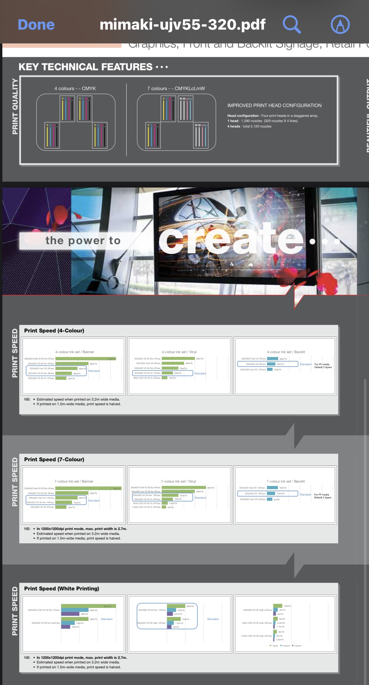

Thanks Worja I concur. Do you have any feedback on the two ink sets 4 color dual cmyk vs 6 color cmyk Lm Lc? I don’t plan to use White since we have it on another printer.
I know there’s a difference but when I see the 4 color Colorado it’s hard to see any reason why I need Lc Lm. I’d be printing the 300x900 or 600x900

The 6-colour ink sets are designed to improve the color gamut and produce more subtle color gradations and finer details. They can be especially useful for printing photographs and other high-quality graphics.
Whether you need the additional colors offered by the 6-color ink set will depend on the specific needs of your business. If you are primarily printing graphics and text, then the 4-color set may be sufficient. However, if you are printing high-quality photographs or other images that require a wide range of colors, then the 6-color set may be a better choice. It's good to think about where you want to expand your business in the future and if you'd eventually have use for higher quality prints.
