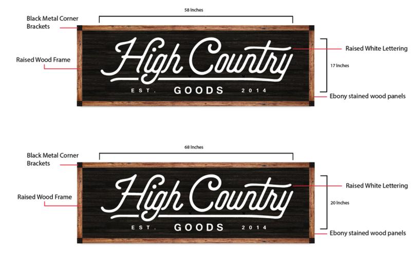

I am building three signs for our retail store. I will be using Woodland Manufacturing to cut out the white letters. I am looking for recommendations on thickness of letters and what material to pick.
I also need to pick a wood background. I was thinking some 1x6 cedar planks stained black, and natural cedar for the frame.
Then what would be the best material to mount everything to? A certain type of exterior plywood?
Any help would be appreciated.

I usually make a section view to see the proportions of the letters to the panel.
My gut says:
1" thick acrylic on "HIGH COUNTRY"
1/2" thick acrylic on "GOODS"
1/4" thick on "EST 2014"
Matte finish on the lettering...
If you use wood, it will probably need maintenance. If you use penetrating oil, usually once a year, a good clear coat - every few years.
I would cleat the sign to the wall using steel angles.
Very nice design by the way...

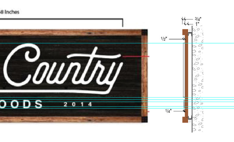

personally I would use 1/2" sintra for high country and 1/4" for the lower copy. 1" is way too thick with that thin of a stroke
Rick
Okay better not trust my gut, trust J. Hills... had to draw it out and his recommendation balances out a lot better...

Rick
I see.. in that case, why not make the height even across all letters?
At some point, small and deep letters look porky when viewing at angles. The "EST" and "2014" might be hard to read or impossible to read unless viewing it dead on or at only the slightest angle...
Making the logo 1/4" is not enough dimension to make it interesting or not enough impact for the effort in making the type dimensional.
Other reason is varying thickness adds more dimension/visual interest to the layout.
