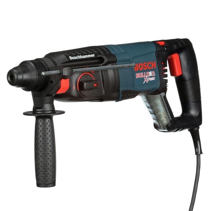

IMO hammer drills suck, for clean consistant hole drilling in concrete I prefer to use a "SDS rotary hammer".
Unlike sign substrates you can take a trip to your local Home Depot and pick up a descent rotary hammer for a very reasonable price.
http://www.homedepot.com/p/Bosch-12...lDog-Extreme-Rotary-Hammer-11255VSR/202080348
Also for banner installs on concrete walls I prefer to use plastic wall anchors instead of concrete screws, use whichever you prefer.
I have both and sometimes hammer drill is more handy. Did install 8 banners 4x20 ft banner 2 weeks ago. Had to work of a ladder at roughly 16 ft height and my cordless dewalt hammer drill did good for concrete. 2 4AH batteries were enough to drill all holes that i needed + very fast install with cordless impact.

SDS is great, I have a dewalt that I got at auction for $15 bucks with case..It was store return almost brand new!
Just Don't always have an outlet to run a cord too. I don't put plastic anchors in because when we remove we plug the hole with grout caulk..or printable caulk and touch up
mfatty500
An SDS or Rotary hammer drill is not necessary when drilling into a Mortar joint, a cordless drill,(hammer, or regular drill with a masonry bit) will do the trick.

SDS's Rock. If you don't own one you should. Hammer Drills will sometimes cut it, but if it's precast concrete, there's just no comparison.
To me it sounds like you really need to find someone to help you. 18' in the air without a spotter or just an extra set of hands sounds like a death wish - unless you rent a scissor lift or bucket truck.
Also, I know folks like tapcons, but I find them hard to use. Crank them in just a little to far and the hole strips out. I prefer an eyelet in a plastic or lead anchor, then from there use some Heavy Duty UV Resistant black zipties to pull the banner tight. These will need to be ordered online as Home Depot doesn't have strong enough ones. This way the banner can be replaced, and you have a tensioning system you can use.
