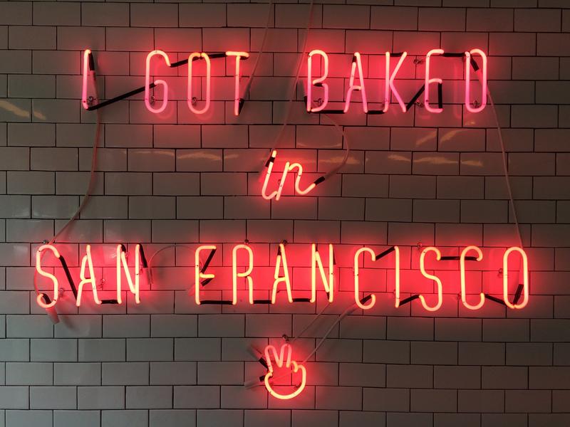

I've been looking and I found this bakery in San Francisco with a neon sign screwed directly to the wall, so maybe the risk isn't so high?

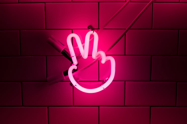

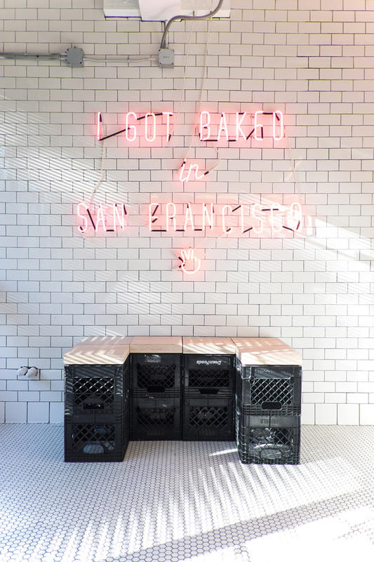

Found more images

Yeah its doable. people screw things into tile walls all the time.
depending on how 'high end' you want it to look, I would do a better job at hiding wiring, blockout paint the correct color, etc
the sign you posted looks way hoakey.
I was thinking the same thing. you might want to show it to the customer as it might make them change their minds as it looks sloppy. if they do say they are OK with it, hire a tile guy to drill for you as they have the right tool bits. another thing you may check into is local regs for exposed neon. we can't have any tht is mounted whre people can touch it. all of it has to have a clear plastic cover oer it.
Billct2
Those look really sloppy, be cleaner with a backer panel than that.
