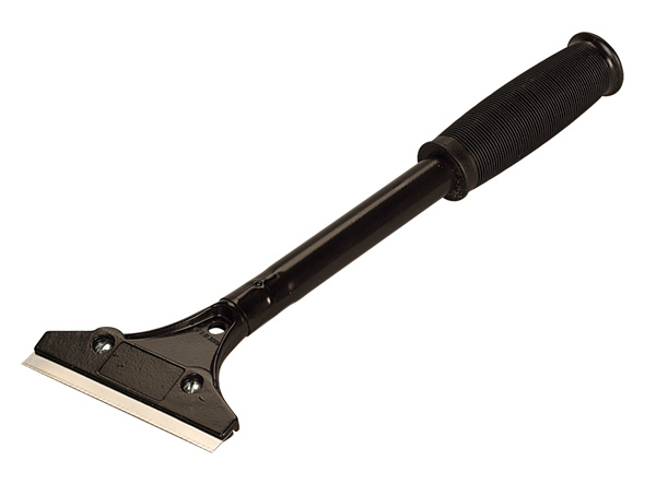

It comes off fairly EZ with a wide razor scraper.
They are like $15 @ lowes

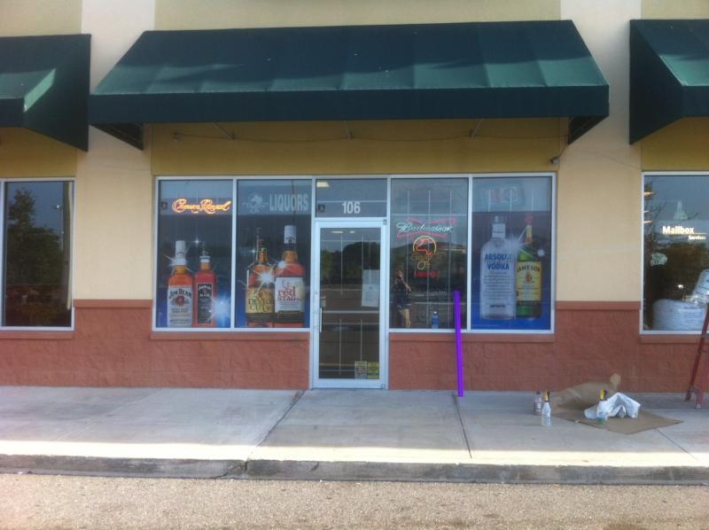

Did two removals of some VERY old toasted perf at 43"x63" (two windows to right of door) and then installed new perf to one of them (far right window) this morning. 1 hour total. I use a 4" sheetrock knife from HD to remove.
