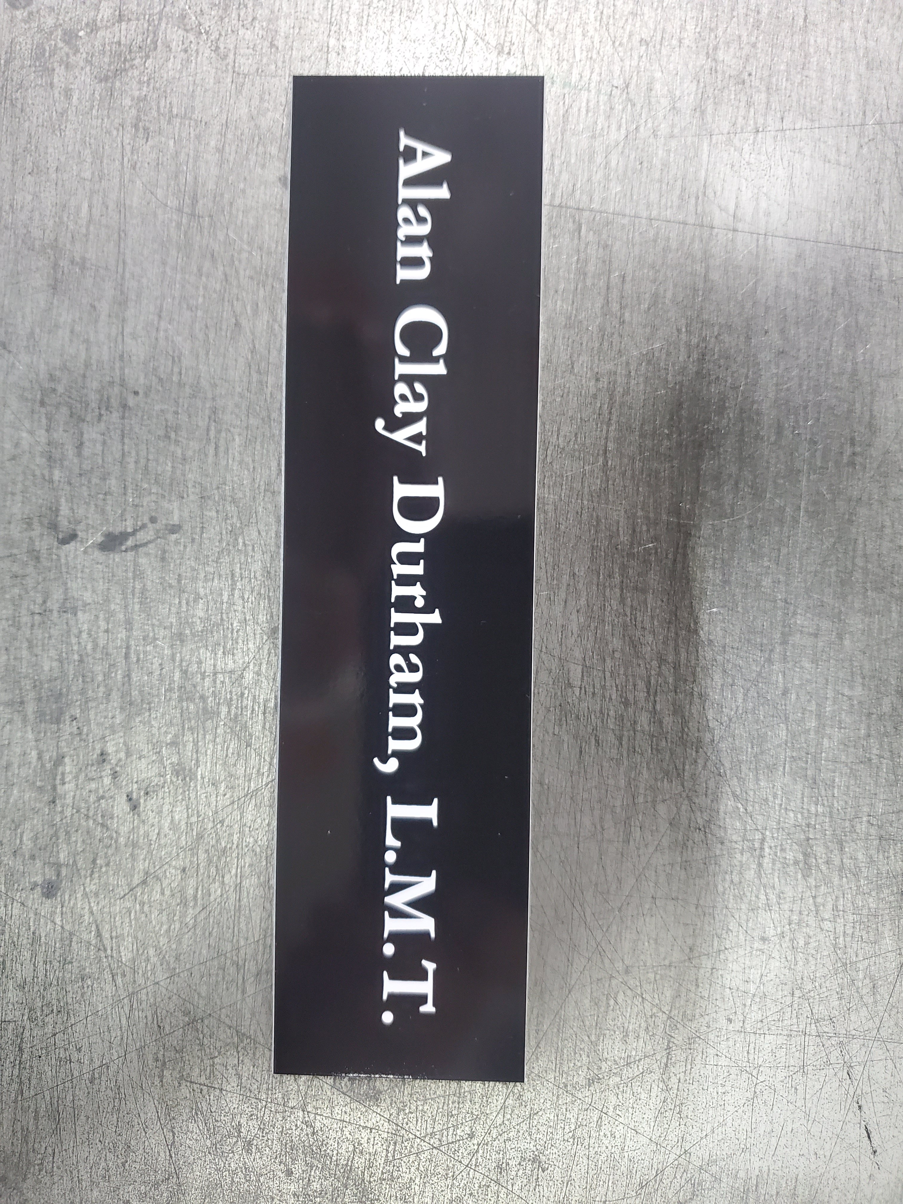

I just finished some
2" × 8" for a customer.
Printed their name reversed out on White vinyl then applied it to .040 white styrene.
Slid right into the holder.
