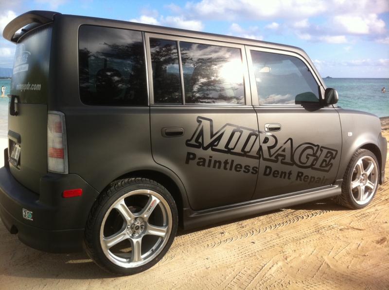

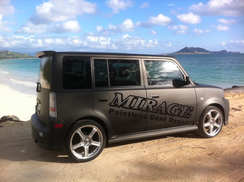

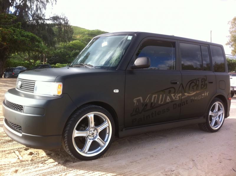

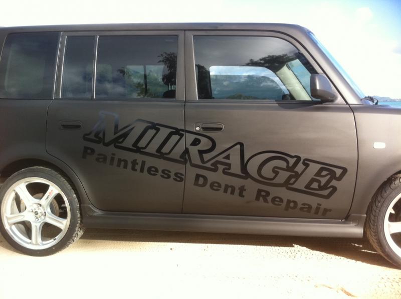

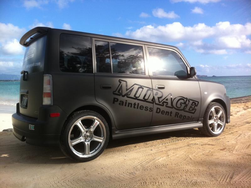

New 3m black matte. Nice!
trimguy
Easy to work with but easy to burn to a shine if you dwell to long in the post heat.

Looks Wicked.
We are working on a wrap design for our van, but it's painted white so I kinda wrote off doing a major color change as I think it'd be kinda hacked to see the interior of the doors though. Hmmm....something to ponder.
We did a large hummer and military style trailer using this material, and had the same issues. Too much heat makes it shiny.

Looks great Sean!

Anyway, really nice looking wrap!

Not sure if this goes for all the other kinds of matte black but I noticed on the 1080 you can scratch/mar the hell out of it and then remove all the marks back to new with a torch.
