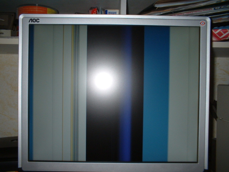

Is there any chance you can take a pict of the white with vertical lines?
It sounds very much like a hardware problem, most likely as others pointed out in your video card (be it onboard or slotted) or in your monitor. If you could scrounge up a loaner monitor to run for a couple days that might be best to start the elimination process. How often does it happen?

I will take a picture of it the next time it happens, and post it.
Sometimes the vertical lines are across the screen L to R and in color, and other times they're B&W and more just in the centre area.

Aha! Having suspected a correlation between the freezing and something video-wise, I played an MP3 song on Windows media player, and made sure to turn on the "Visualization" effects (you know, that LSD like stuff that randomly goes on while a song plays). After a couple of minutes, she crashed...........here's a photo. The screen looks different each time it happens.
Sorry 'bout the flash.

I think the problem is in the pc. Not the monitor. have the store replace video card then make them re-do the media player test you did. If you have an on-board video get a video card. The on-board shares memory from the system and is slow. Nvida-6600 or so is a nice card. 175 bux.

Man, I would now bet a bag o' nickels that it's the vid card. But, ya know, I shouldn't because after all....I'm not EVEN a "basement geek" so what the hell do I know, eh?

I sent this photo to the comp. store and they said "Motherboard", and a guy is gonna be here in 1/2 hour to put in a new one.
