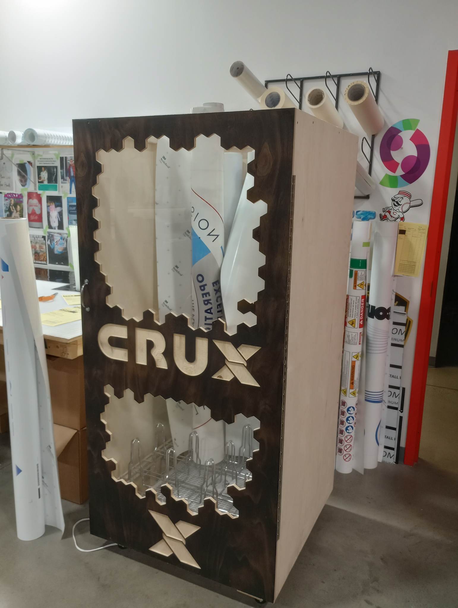

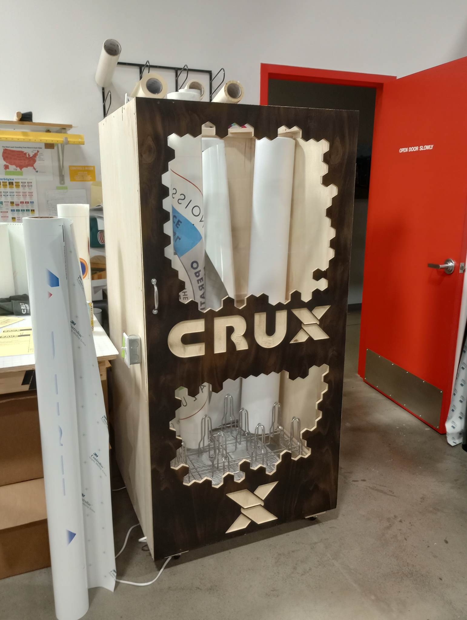

Printing too much for the old box so had to add another to keep up with the flow around here.
Made this one to comfortably hold 16 rolls if necessary. It REALLY pulls the air through, way better than the old one.
Not 100% finished yet, but it's in operation. (we are adding lettering below the "crux" later)

That is very well done!

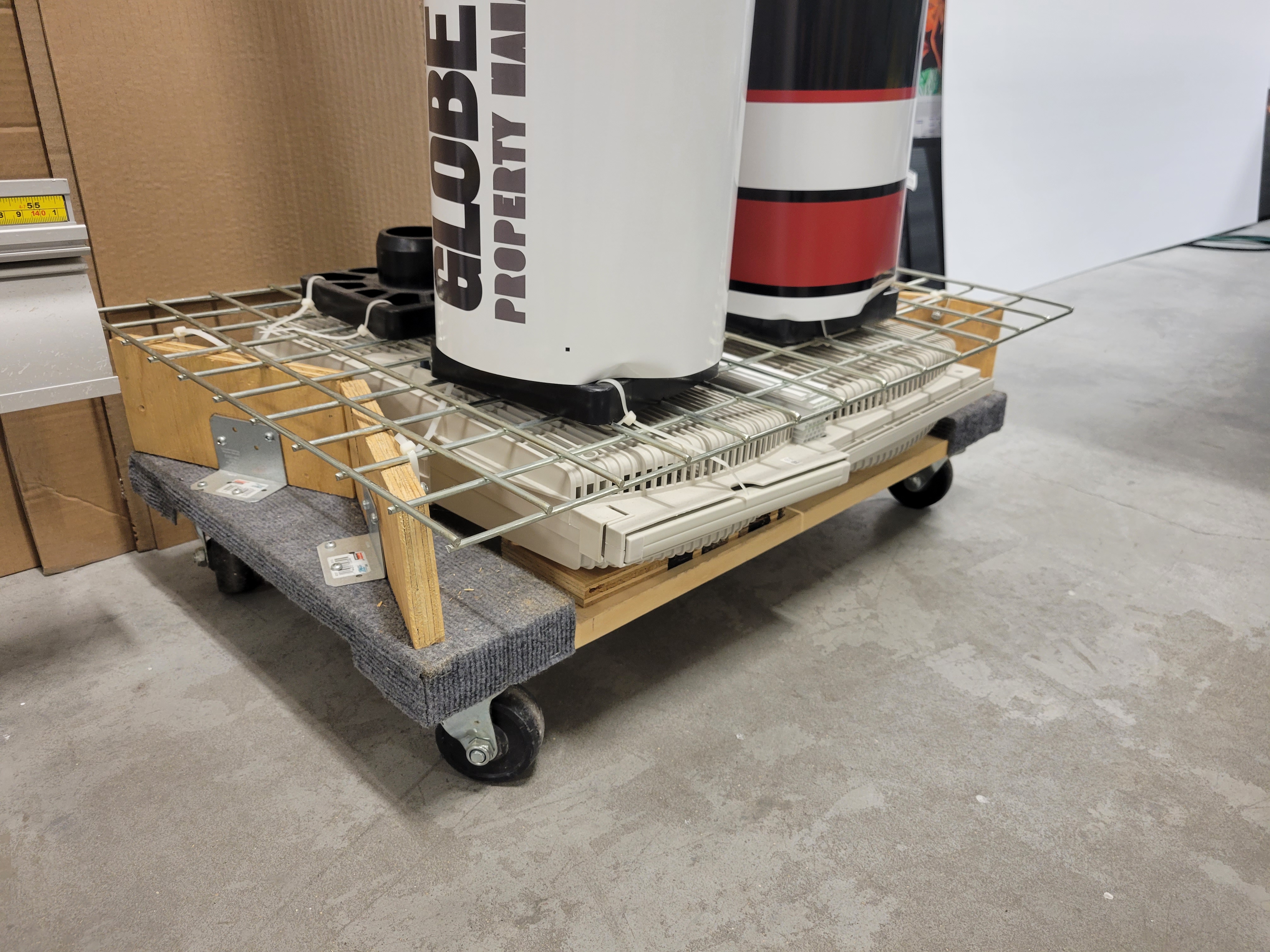

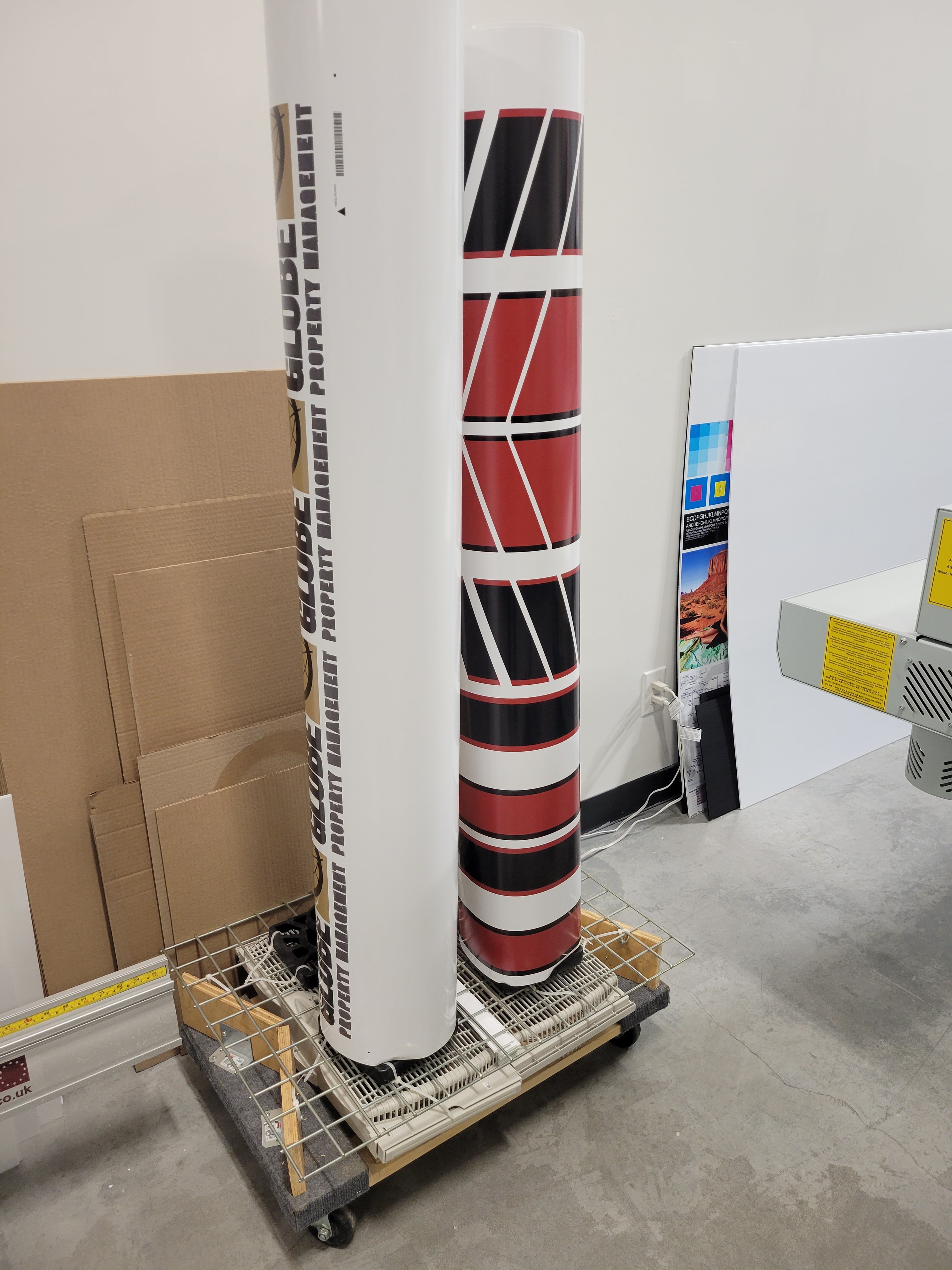

jfiscus
Rap Master
The fan is pulling air down through the rolls and blowing it out at the bottom so not putting any more dust onto the prints than is floating around already. Customers are getting more and more pushy with turnaround times and even with multiple printers running all day long we're still overbooked most days. When you take a roll off of a solvent printer's take-up the solvents are still trapped within each wind around the roll unless you give them somewhere to go. Loosening up the roll and letting air pass slowly over it ensures a better final product. Remember, solvents are heavier than air and like to go down.
I have seen and tested MYSELF the difference in prints that were rushed (and failed within weeks) versus prints that were allowed to off-gas properly, and have yet to fail years later. Same exact print/material/laminate; just a different length of time before lamination.
it might not make a difference on flat cheapo signs, but you will have failure on wrapped recesses popping out on vehicles due to the solvents attacking the adhesive once they are trapped under laminate.
Anyone who argues about solvents off-gassing being a myth must also believe you can stick vinyl onto a vehicle that was just painted or a wall/surface that was just painted.

Very cool! Nicely done. Ours looks pretty ghetto in comparison lol.
Did you put acrylic behind the wood door? What did you use for fans? I bought some cheap (crap) window fan things and they don't move enough air, have a new offgas set up on our to-do list for this year.
It is just a standard cheapo box fan at the bottom. Our first box was built around 9 years ago and the fan on it is still going strong, lol. I thought it would have died years ago. We have acrylic behind the cutouts in the door; got to get a good seal around all sides so that the flow of air works best to pull down through the rolls. Anything is better than nothing though.
