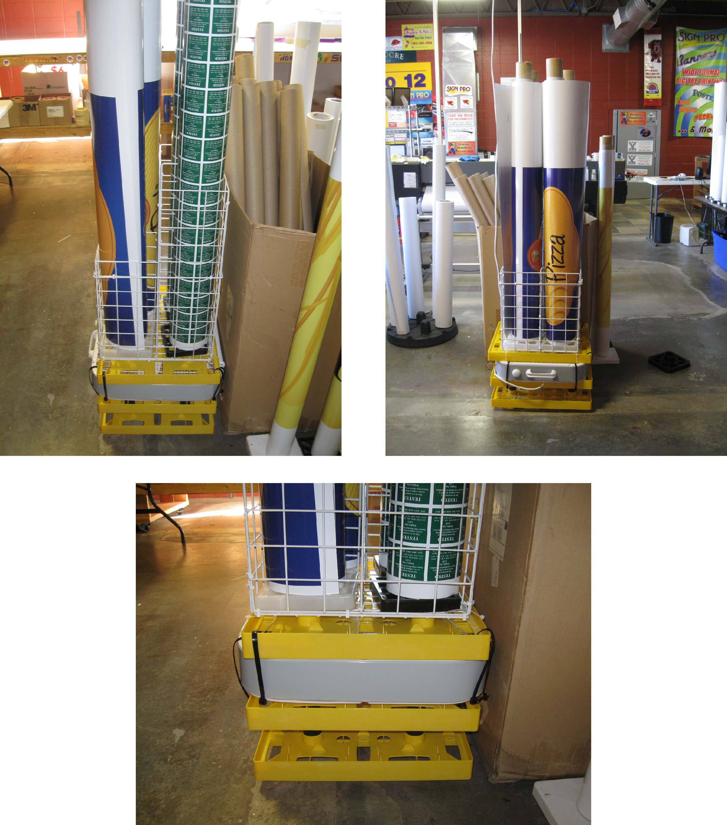

Sign Pro Salina
Printing too much for the old box so had to add another to keep up with the flow around here.
Made this one to comfortably hold 16 rolls if necessary. It REALLY pulls the air through, way better than the old one.
Not 100% finished yet, but it's in operation. (we are adding lettering below the "crux" later)
Nice work! I built our crude one about 12 years ago or more. On it's 2nd cheapo box fan. Now the motor in that one is going, (they run 24/7) & the cheapo retail store plastic fertilizer rack I re-purposed has broken where I added wheels on the bottom at the corners. It's time to build a completely new one. I like the way yours is set up. We also have the problem of needing more roll space at this point.

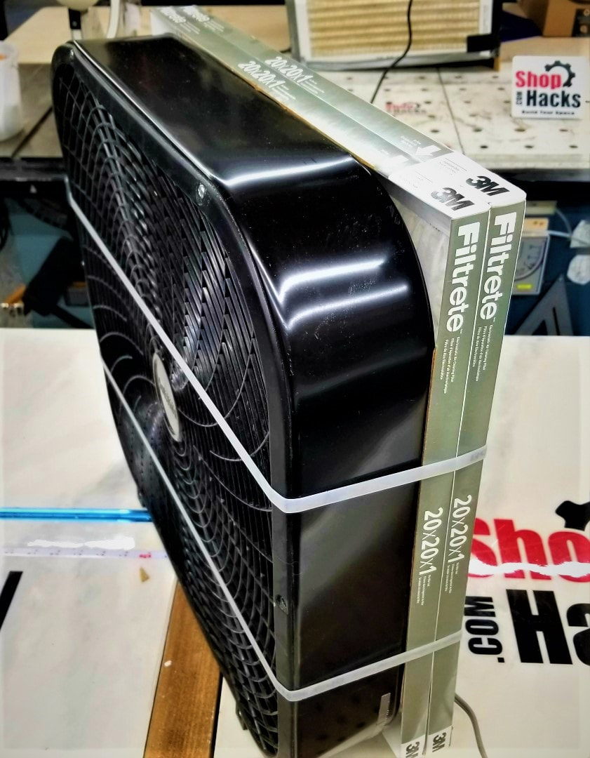

Whenever I see a box fan in a shop, I keep thinking about integrating a filter to clean shop dust out of the air. Seems weird to filter the air after it gets pulled off of the print, but air flow is air flow, right? And some of you are running your fans all the time. Wonder how it would work.
Any of you guys considered adding filters to your setup?
