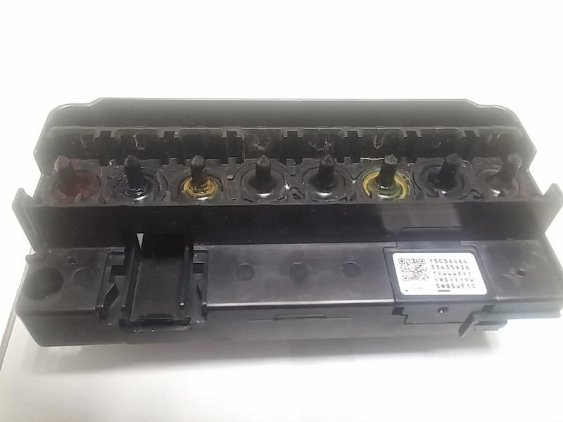

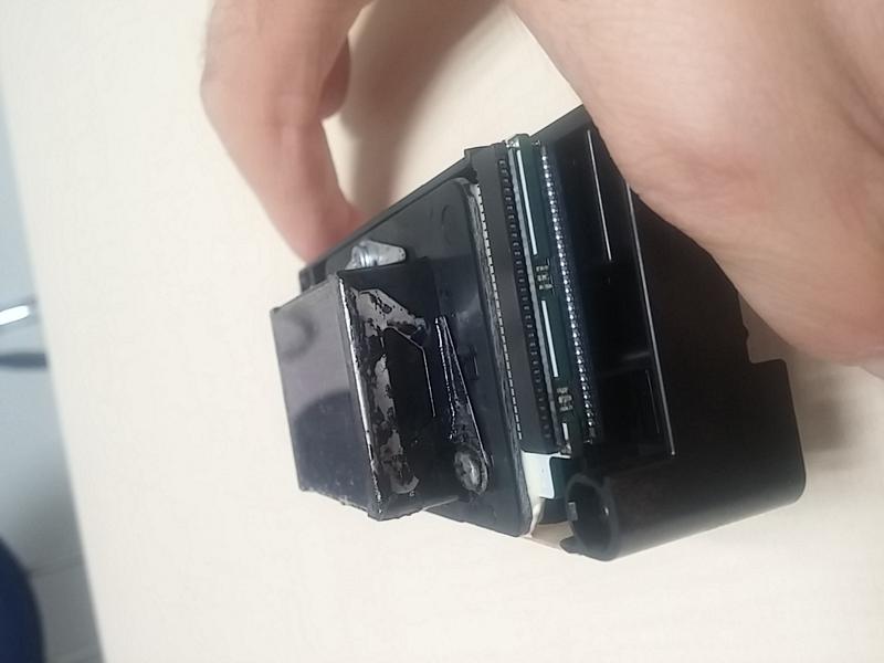

Hello eveyone,
We have 2 JV5's and 3 TS5's. I have to say that we can use F160 and F187 DX5 printheads. It does not have to be original Mimaki dedicated printhead.
We have been using this way for three years and I see that it is highly possible that people aren't mostly aware of that ability.
There is a guy who downgrades some kind of firmware in JV5 and TS5 so that we can use the heads shown below (without and kind of Decoder/decription.
Printheads for JV5:

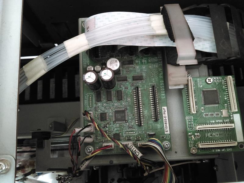

Hi,
I have three DX5 machines, one JV33-160 and two chinese, in all the machines have printheads savaged from R2000 printers ($100 USD new), i placed a decoder card between mainboard (or slider in the mimaki case) to avoid the 60cm band, here a picture of board in the JV33 printer, aside the slider board, for mimaki need to use firmware V2.2.
Hope this information will be useful for you.
Regards
Edgar
