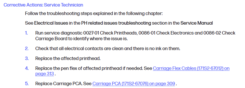

We get this errors such as:
C9 6A 17 0B
0027-0001-0184 event
0027-0001-0484 event
We tried cleaning the connectors as the manual orders but with no success.
There were no printhead strikes or jams...
For now I've been able to get replacements with HP Warranty, but this machine, for now, is really unreliable...
What could it be? Any guesses? The technician that installed is from the authorized vendor, hp certified and such... or as I was told... (the technician had some hiccups during installment and training, not showing good domain of flexi -- but as we are using flexisai is kinda lame, we are used to Konica Minolta rip/driver and flexi is so buggy)
