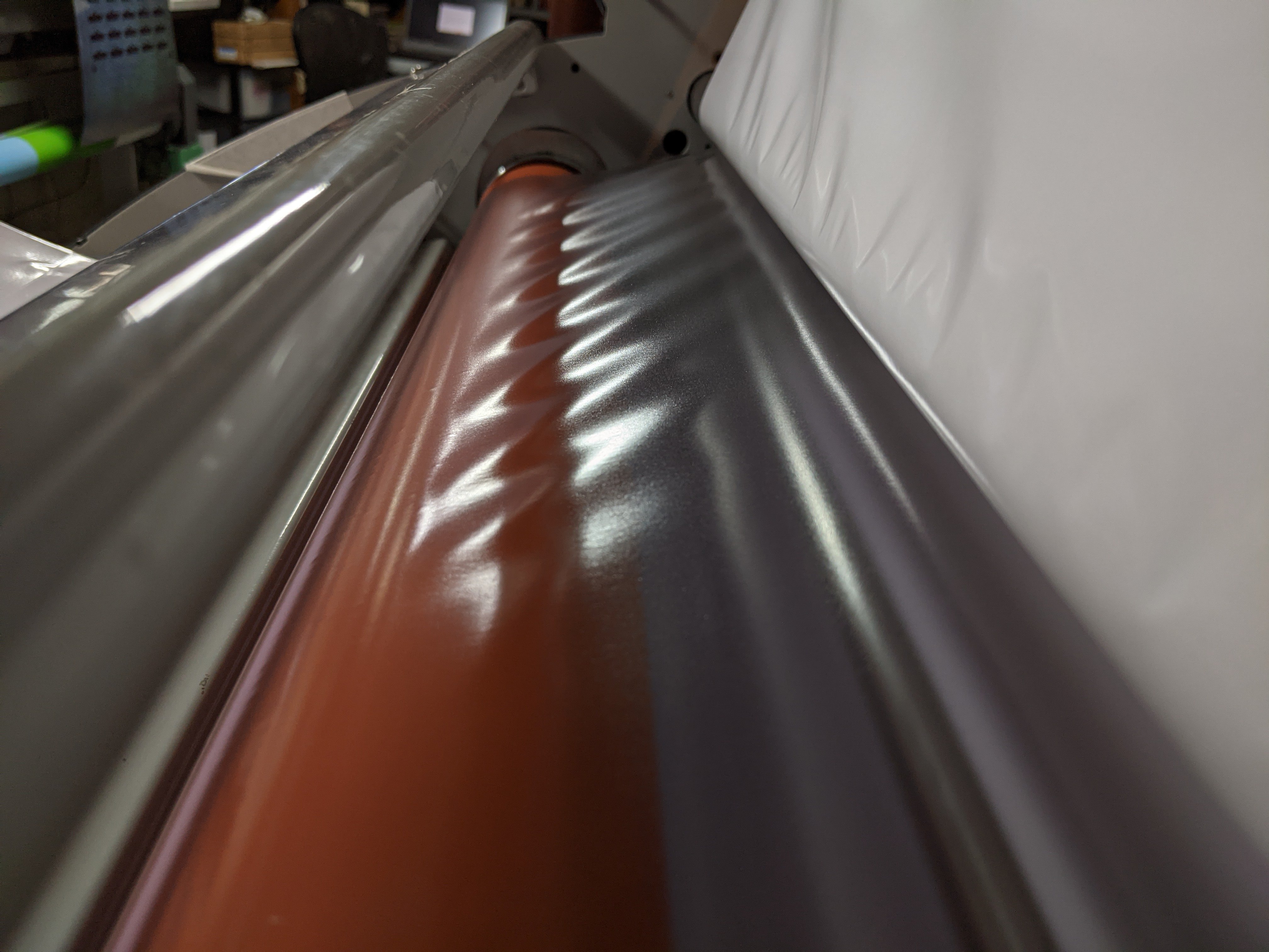

The laminate will sometimes get waves when it's coming off the roll, and I'm thinking some of my cutting issues are because of this. I've noticed the cuts aren't cut as deep on the outer edges.
Something I didn't know....I do know that one side was higher than the other but the tech measured the pressure and got them as close as possible to be even all the way across. And even if you look at the roller adjustments it says to have even pressure all the way across.
I'll say that I don't have any techs anywhere near me that can help. The guy that came was from Bell & Howell to service it and he said they only really do installs.
Notarealsignguy
Arial - it's almost helvetica
If it gets a little wave like that put your hand on the roll of laminate for a little tension and it will usually go away. Make sure you are loading it straight too. I doubt it's the laminator, we have one that is way out of wack and it'll still do the job as long as your tensions are right and you load it straight.
Yeah I'm going to refeed it and reset the tension on it to see if I can smooth out the "waves". I just never knew these were crowned and neither did the tech, which means I have no teach to even service this at all. I do have new pressure springs if I need to put some of those in. I'll start with the easiest solutions first and see.
