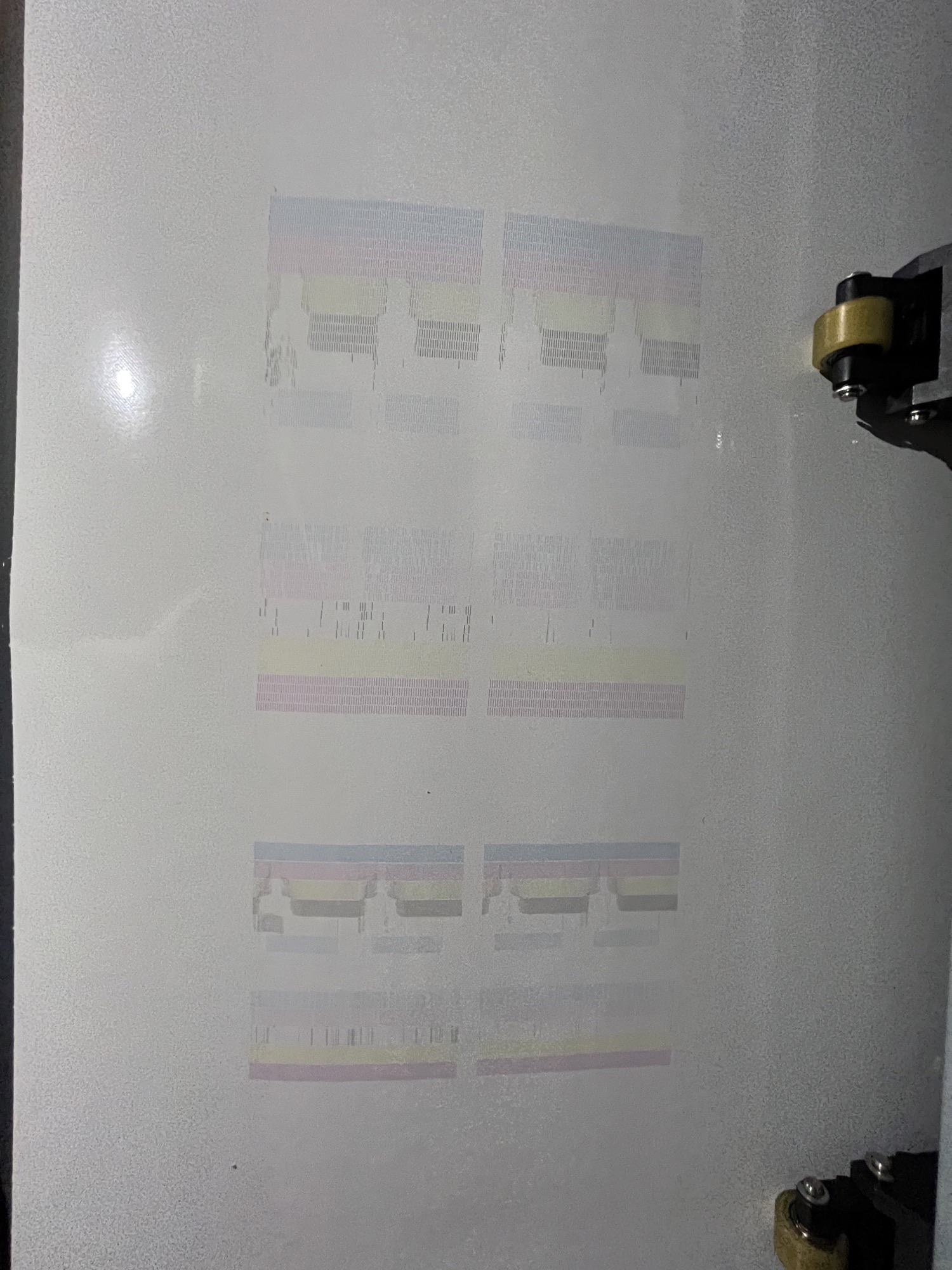

Both heads destroyed in a head strike???? 7k???? Wow...
Just for curiosity, can u send a complete printhead test?
About strikes... Usually bad temperature (much temp), vinyl stored in a very different room temperature, dirty or bad or uneven vacuum "things" (sorry for my english lol), a stucked pinch roller, or a bad calibrated enroller. But well, most common, the first one.

Here is a print test and parts break down on cost.
2 heads $4272.00
8 dampers $863.00
2 Cap Tops $178.00
2 hours drive time $250.00
5 hours service time $1250.00
total before tax $6813.00
tax $546.00
total $7359.00
This is what they want to charge me and I can not find any place to buy genuine Roland print heads. I know I can change these by myself easily in less than 2 hours. they did say that if it doesn't take as long as they think they will refund the part of the service price.
This is an eight color machine with white and silver.

$250 per hour service is on the high end for service from what I've seen but you are also in New York so that may have something to do with it. In general I see $150 - $200 per hour from the techs I've worked with around the country. It also looks like they quoted all OEM parts which is normal especially for a dealer tech. That's the price you pay for a warranty unfortunately. You could save around $2k - $3k by going with alternative parts but then you would have to find an independent tech or do it yourself which negates any warranty. So there's definitely a trade off between the options.

Heads strikes on vinyl should not be able to cause permanent head damage after just a few swipes. Sure, it can cause clogged nozzles but usually it takes the head hitting an edge clamp or something in the capping station to cause significant permanent damage. Look at the travel path of your print head and see what all is in line with the damage that your head could have possibly connected with.

BTW, I had an independent tech replace 3 print heads on a used VP540 machine. He charged me about $1000/head with installation.
Your quote for $4272 for 2 heads, ouch, sounds like gouging to me.
I just ordered 16 dampers for our Roland from SolventInkJet, I think they were about $10 each.
Your guy wants $863 ?? Whattup??
Original Roland Cap Tops for the VP540 were $40 each from AllSquare in SC.
The 5 hours service time sounds close, kind of, but an additional $1250 on those crazy parts prices?
I'd be looking around for an independent tech or another dealer or another brand of machine. Just sayin'
