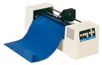

This is what the vinyl should look like 15 inch wide.
