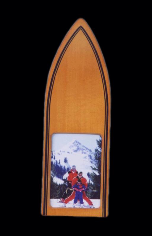

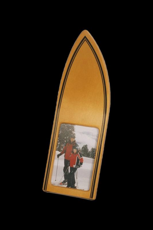

Thank you for letting me join Signs 101, I am a new member and would like to introduce myself. My name is Annie. I've been in business for the past 12 years. We manufacture picture frames.
In the past my frames have been engraved, but I would like to offer the option of putting on a
COLOR logo on the frames, or heat press the logo onto the frames. I am open to suggestions for either some sort of printer-die cutter that would cut out the logos exactly. I would most likely only make about 1000 logos for the first year. The logos would only be about 3" x 3" and would be applied to a picture frame that is wood, and wouldn't be outside.
There are so many printer-die cutter machines out there, that I would like any feed back if possible to find one. Roland, HP, Gerber edge, Mimaki, or any other one you can inform me about. Many of the logos may have the color white in them also..I am looking for a sturdy printer-cutter... but it doesn't have to be huge for the type of logos- artwork that I would need made for my picture frames.
We tried a heat press to apply the logos from a company on my products, but the heat damaged the wood. They looked great, but the wood split. So I think my only option for color is to get a printer-cutter. Or is anyone familiar with digital inkjet printing that would go directly onto the wooden picture frame?
I would be so grateful to get any feedback from you members. Thank you!

If I am correct, your picture frame is made from the end of a ski, and the pointed end is turned up (not flat), if this is the case, I don't think you will be able to print directly on the curved wood frame.
Most direct substrate to printers must maintain a specific constant distance between the pint head and substrate, and the curved upward part of the frame would strike the print head, which is very bad.
I think your best option for the curved ski picture frame in to apply the logo that would be printed and die cut on a small printer like the Roland BN20 using a white vinyl material.
