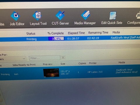

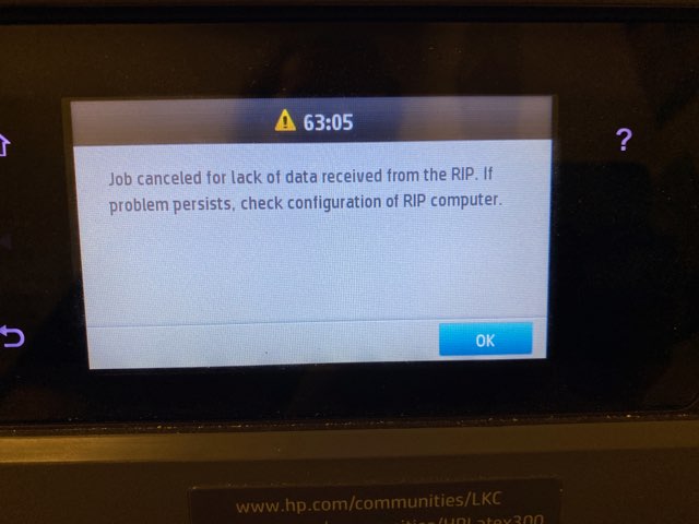

I recently had onyx installed. It printed our first mural great. Then went to 2nd, lett the shop for an hour came back and got this warning? What is that about? We are running off a laptop, I was recommend to get a tower.
But never had this problem with Flexi and laptop. Any ideas?
I have automatic updates shut off, so it was not that. Maybe hiccup in the server?

in general you should always have a rip running on a stand hole pc not a laptop...too many resources running for monitor etc...it will always be slower. if the pc goes to sleep everything stops
