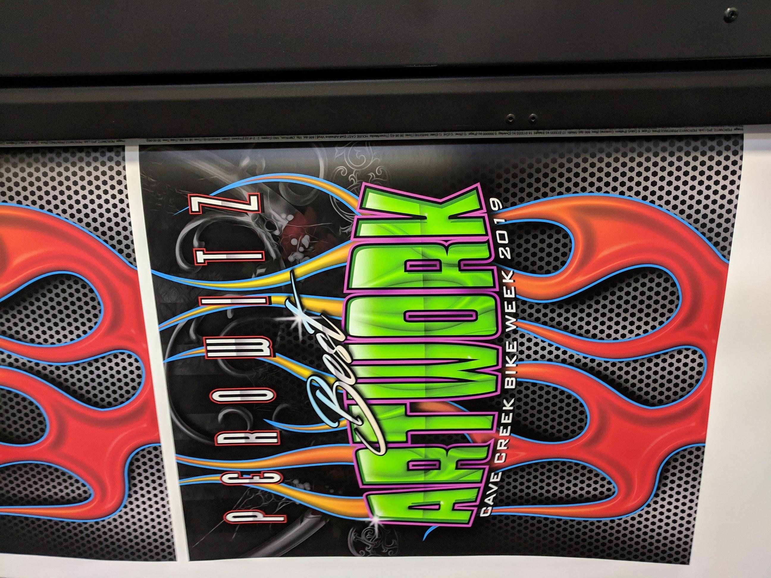

Why do they run the Epson at 8 pass in the video, but 10 pass with the HP

Because the Epson at 8 pass is equal quality wise to the HP at 10 pass
But when profiled correctly the HP 6 Pass is on par with that 8 pass
This is 6 pass
