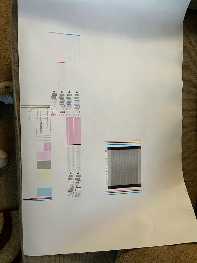

The HP printers are probably a lost cause, they stopped making supplies/parts for them a while ago so they're going to be harder and harder to keep running as time moves along.
The JV33 should be able to be repaired if you can find a good local tech and reasonable parts. (The last good local Mimaki tech I know retired) What does the test print look like out of the printer right now?

these are the test plots I printed today I need to figure out how to get hard drive to update because i did work around the head issue I'm embraced about how I had to do it but ill tell you anyway I removed the magenta chip on both and took two cyan heads that I had flushed ink out and put the magenta chips on them trimmed off the black tab that prevented me from inserting in carriage manually primed the pens with a syringe and that test plot was the result of a few hours of printing past to get to magenta instead of purple

We are going to need a closer look at just the test print from the Mimaki to determine how the heads look. When it uploaded it is too hard to make out.

I have got it to take the latest which i believe is sp-sp 12.0.2.1 bot the os sp os 0.0.3 and I don't know if that needs upgraded

reply its current sp12.0.2.1 it seems like the ink prints good once then prints broken your right didn't help
