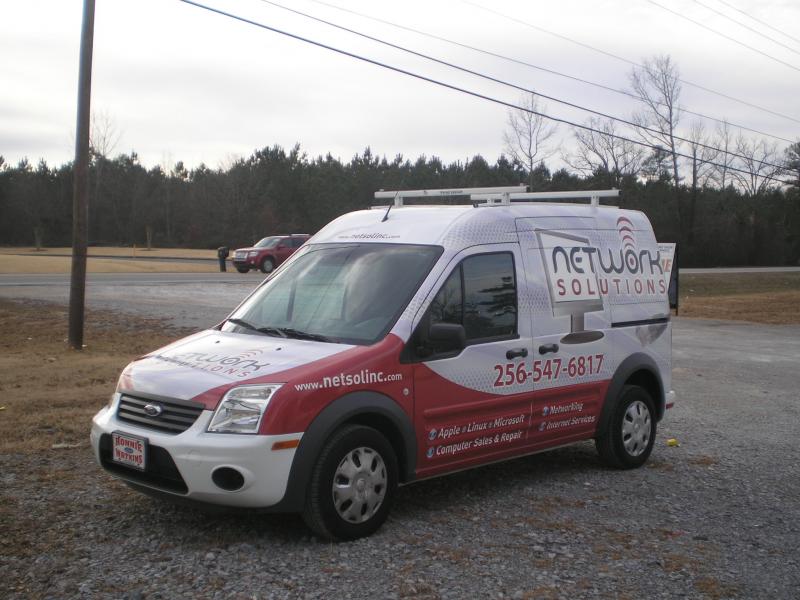

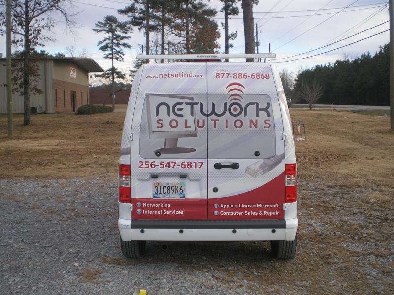

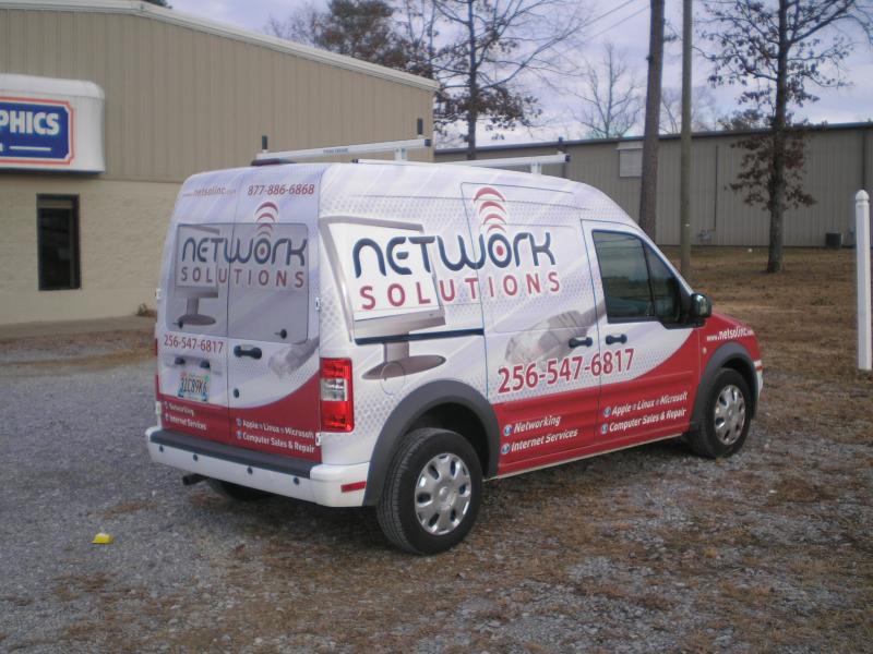

Just got done with this one. These are easy to install except you can't get the damn door handles off. Enjoy.

looks nice but the website is really hard to find; especially for a computer company. Did you just cut the oval out for the handle recesses?

I am not sure how Ford is doing things, but the new Jeeps (and most Chrysler products) have moved to a more modular type door construction. Meaning the window regulator and latch mechanism come out as one piece (these have to come out to remove the door handles). It sure makes it easier to work on, that is after you figure out how to do it.
Brands Imaging
looks great...did you contour cut the recessed "window" area or bridge or direct feed?
either way...it looks great, nice clean design. not a lot of ink either!!

Not to bag, and it might be the pic, but the Network Solutions looks like it is lower in the back, not level. I see this all the time with people who measure from the top, you need to go grom the center rib. LIS it might be the pic...Other than that looks great.

On these vehicles it takes maybe an extra 5 minutes to remove and another 5 mins to reinstall door handels. Makes for a much cleaner install. Do search on the ford transit and you will find some write-ups here.
Sparky
Can I ask why you are removing door handles?
Hands/fingers/nails pulling up seams near a part that is used every time you need to get in, or take 5 minutes and remove the screw, then door handle, wrap in recess, pop it back in and re-insert the screw?
Easy decision!
