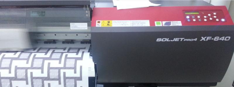

I have three XF-640's bought in March-14; April-14 and May-14.
In the beginning I had all patterns in 2 (60meter sq/h) passes with no issues. As months passes, printing quality decreased and we increased number of passes to 3 and 4 (30meter sq/h).
The issues we have is some light colors with some specific fabric which is 10% of all work. But we haven't had such big problems so far.

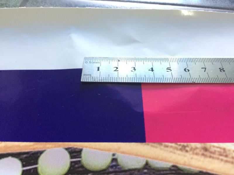

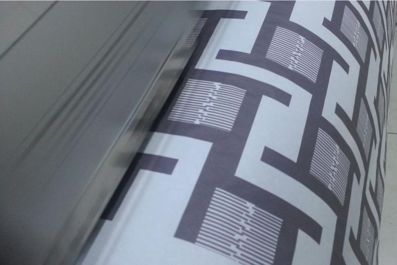

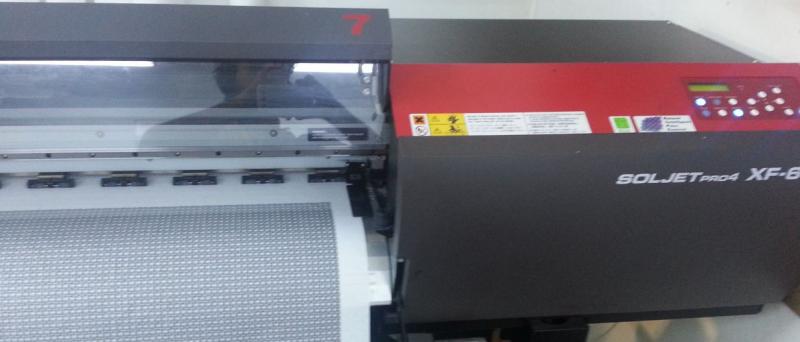

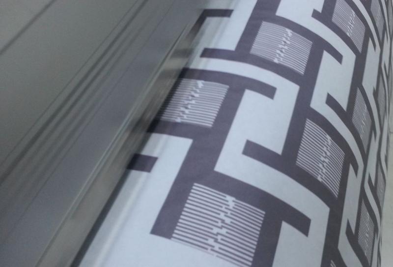

I am posting photos of each ROLAND in case it will be useful:

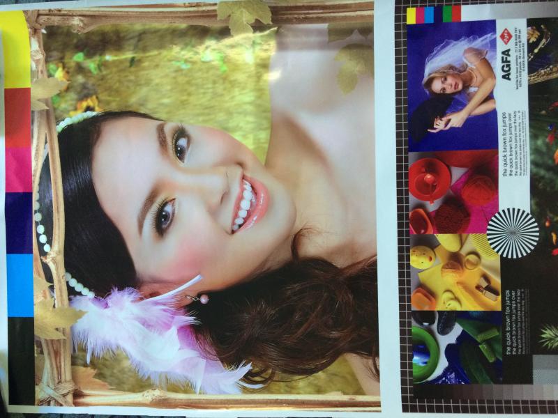

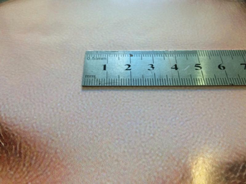

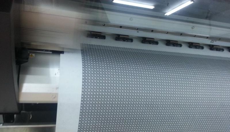

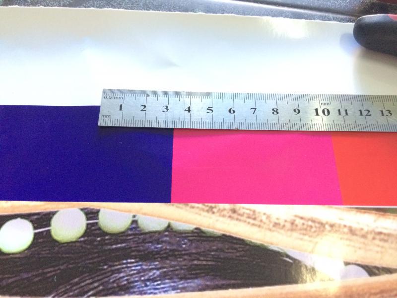

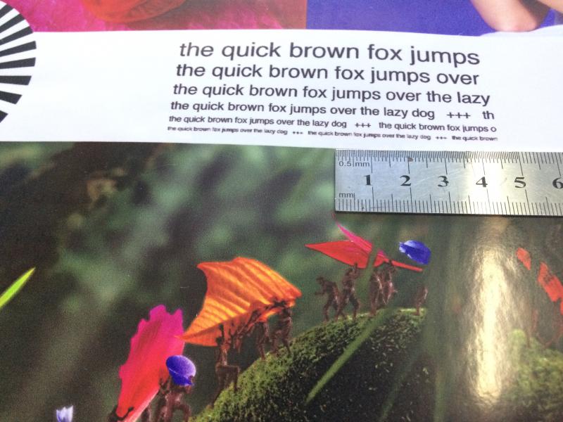

I have attached current printing samples.
dev_7 is printing in 2 passes (relatively a very easy pattern).
dev_1 and dev_2 are printing in 4 passes. ==> Months ago we used to print with 2 passes such patterns.
The supplier claims that printhead is overused in months (we work 7/24 in textile business). They say that printhead replacement solves all our printing issues.
