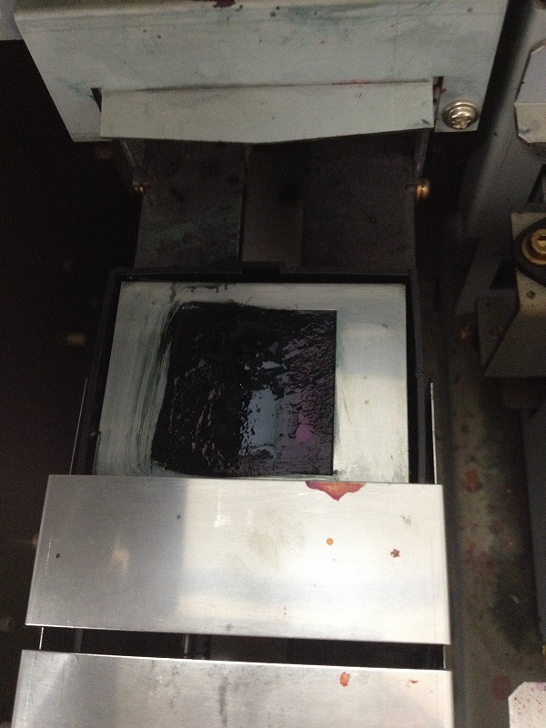

Hi everyone,
My name is Alex, I'm new to this forum. Also, I'm a newbie into printing on vinyl. I used to make "cutted" stickers.
I just bought a new SP-300V go get familiar with printing. I bought it used, the guy that sold me this printer, print me a sample and the result was pretty good. Except, it has a few drag line uppon the vinyl. He told me that the machine needed a good clean up.
I did a good clean up (following the how-to video on roland website) with the solution and stick.

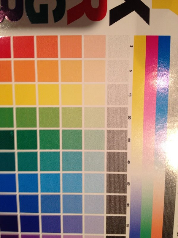

Now that I have cleaned everthing I did a test print and the result is not very good. I have too dark colors and it have line into the graphics (like scanner lines). The guitar in the test print supposed to be colored and it is very faded. Plus, the cyan is too blue.
I don't know what can cause this. As I said, I know nothing into the vinyl printing machine, If someone have a clue for me it would be greatly appreciating.
P.S. On the how to clean video they said to clean that part of the machine (under the operation panel) but only into the border. It look like I have a massive build-up of ink in there, is this normal?
Thanks a lot

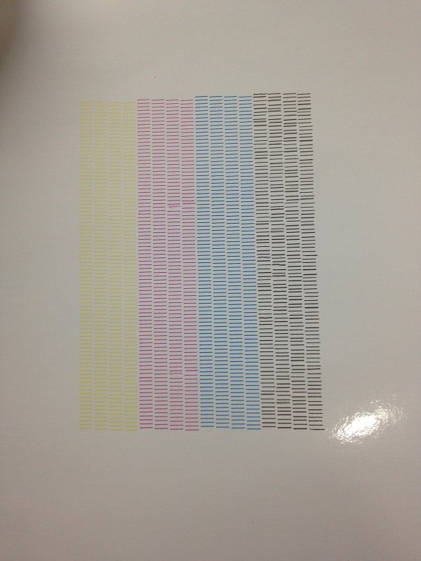

Your fill tests look good from the picture... can you post a picture of a nozzle test?
(on the printer hit base point then hold test print)
Pat,
Is the nozzle test the print with the lines in each color? If it is this, the black have a few lines that are not at the right place and all other colors look good (maybe one or two line not a the right place)
I'm not home right now I could post it later.

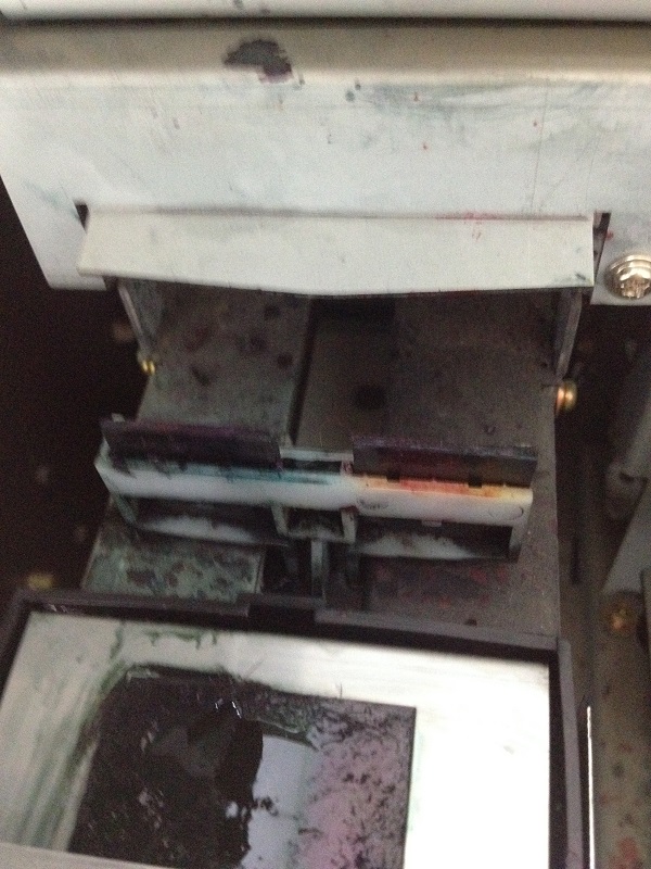

Not 100% sure it applies to the SP300, but have you cleaned/replaced the wipers and cleaned the wiper cleaner blade? On our VP540, they get gummed up pretty often, and it can cause streaks in the print if the wipers aren't cleaning the printheads properly.
aqpaint
Hi!
I did clean them but not replace them. They were very very gummed, now they are not so bad, I'll order some to try repace them.

There are test prints and adjustments for material thickness. I'd print those alignment tests and set the adjustments. Also, there are settings for the interleave. Somewhere there is a setting that adjusts for the thickness of the material.
As Pat said, check that test print. If you have some lines that are missing you have some nozzles clogged up, if you have some out of place then you have some deflection. If it was my printer, I would do the alignment and make sure that was fine first. I think it is in the submenu on the printer, and then run a normal cleaning and see if the test print clean up some. If not, may need to try running a powerful clean or two. You might be able to get some missing lines back if they are not there. After that, I would try some different profiles in VW. The faster speeds will not be as great looking as the slower ones. Post the test print when you get the chance, might help some.

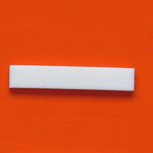

It is a SP-300V, is it the same pump and cable carriage? What do you mean by new caps? I did change the sponge but I don't know about the pad..
EDIT: I made a research and I saw that it have T pad and sponge, so I change the sponge that look like this:

The black head has some problems, high quality print mode could take it out but is painfully slow. Try the cleaning and adjustment tips above and if that doesn't help do a manual head soak (search the forum). Our SP300 black looks about the same, maybe a tad worse but that is from the previous owners head strike into the material. The only solution to that is to change head but with right profiles you can still get decent output (works for us). It should not have ink gummed up around the head so try your best to clean that out also. Good luck!

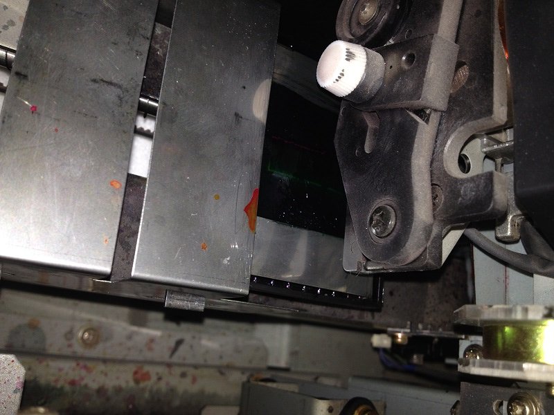

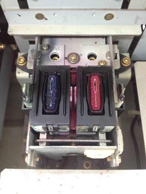

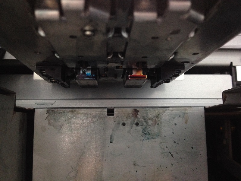

I did clean the machine, here photos of differents cleaning points. I cleaned the print heads and the contours were on metal, I did a few print tests and they are already this dirt, is this normal? Also, there's is a square filled with ink in the middle of a metal border, what is this? Is it normal that it has a lot of ink like this?
Thanks a lot for all your anwsers guys!

Are those the after cleaning pictures? Heads should be free of ink - it has probably coagulated so you'll have to gently rub the sides with a solution soaked swab until it comes off.
As for the sponge, I believe it's called "Surge mist Upper sponge" and should be replaced. They're only a couple of bucks.
Yes thoses picture are after the cleaning but after a few prints. After the cleaning, heads were completly free of ink. But after a few test prints, they look like this. Can it be because of the sponge? Thanks!
